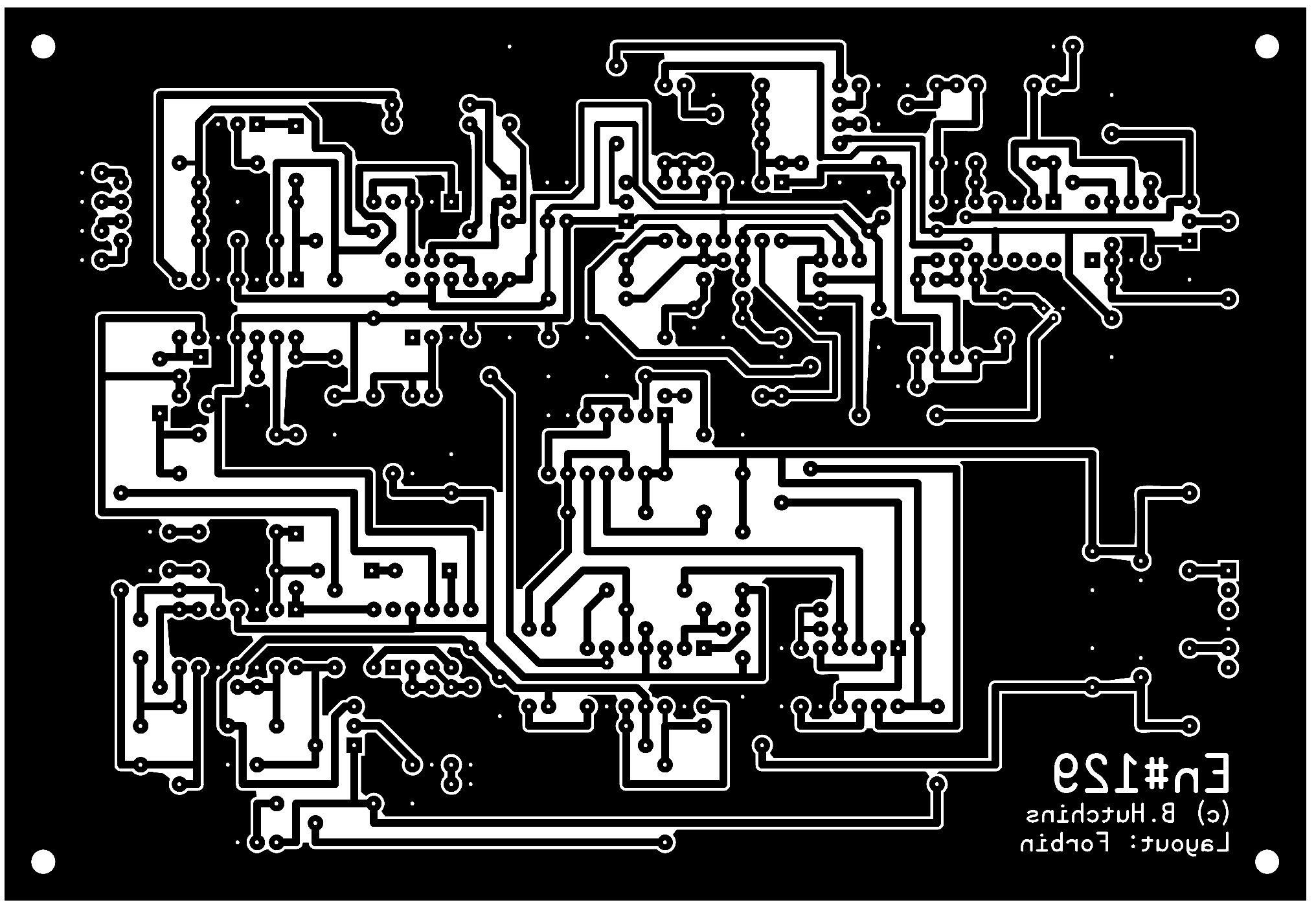

Here is a Press'n'Peel layout for the TZVCO from Bernie Hutchins as decribed in the ElectroNotes 129. Bernie has given me the OK to put this out here for anybody to use in a non-commercial manner. Please read all the notes and especially his original excellent article. There is a lot to be learnt by going through this circuit! I will post a TIFF of the PCB as well as it is often easier than getting the scaling right from a PDF!

Here is a GIF -- it was smaller then the TIFF. Has the advantage for drawings that you don't get the artifacts that JPEG produces... it is at 300 dpi by the way...

Do you by chance have a component side drawing?

PostPosted: Mon Mar 08, 2010 9:49 pm    Post subject: Reply with quote  Mark this post and the followings unread
It is in the PDF -- in the first post...

3080 though, but I could always put a 13700 on a protoboard beside. Very Happy
Any BOM? panel wiring diagram?

Has to be a 3080, have a read of the notes.

Hi:
Thank a lot for the layout!!!
Can I use a 2SA798 instead the SSM2220?

yep, my vero-board version uses a 2sa798

PostPosted: Sun Mar 14, 2010 4:18 am    Post subject: Reply with quote  Mark this post and the followings unread
Looks to me like OTA-1 does not need to be a 3080. OTA-2 does need to be a 3080, because it uses the the special W. Jung trick. You could replace the VCA with a 13700-based one.

PostPosted: Sun Mar 14, 2010 6:43 am    Post subject: Reply with quote  Mark this post and the followings unread
True Ian -- i did contemplate quite a few changes -- especially making the integrator and the sine converter an LM13700. It does make the PCB a bit more of a nightmare! With 3080's still being a few dollars from Futurlec I decided to keep it faithfull to the original... Now having built it... and debugged my stuff ups in laying it out... I would not really change that much!

Hi Forbin:
I just read in your blog that you missed some resistor in your TZ VCO PCB design.
http://forbinthesynthesizer.blogspot.com/2010/02/through-zero-plane.html
Do you corrected the PCB layout posted here?
If not, could you name what resistors are missing?

PostPosted: Tue May 11, 2010 9:44 pm    Post subject: Reply with quote  Mark this post and the followings unread
The posted layout is fixed. I moved a couple of bits slightly as well as i found some tracks a little bit too close to each other. If you look at the photo on the blog and the layout on the PDF file i think that you will notice the slight changes in a couple of the IC's... Certainly a lot less painful layout than the 921B... my work colleague keeps suggesting 4 layers! which is fine for BGA's but a complete cop-out for through hole!

PostPosted: Wed May 12, 2010 10:47 pm    Post subject: Reply with quote  Mark this post and the followings unread
Etched a board tonight and the sizing came out wrong for me. I think the pcb layout needs to be a bit larger to accommodate the ICs and resistors better. Also, the spacing between the ground plane and traces could be a bit wider.
I'll let you know how it goes when I finish this tomorrow.
