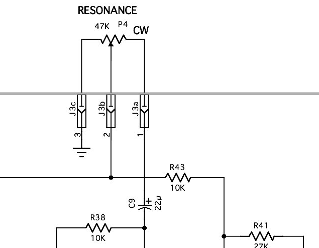

PostPosted: Wed Jan 25, 2017 1:36 pm    Post subject: Reply with quote  Mark this post and the followings unread
sorry Yves,
i've been trying to get my head around that diagram, but no, i can't seem to figure it out. CW and CWW are clear.
However, two wires are attached to the wiper. One goes to the R43 (the yellow one).
What about the blue wire (wiper). Where does it connect to the real circuit?
thanks ! scratch
 Filesize:  37.12 KB
 Viewed:  348 Time(s)
yusynth
Joined: Nov 24, 2005
Posts: 1314
PostPosted: Thu Jan 26, 2017 12:24 am    Post subject: Reply with quote  Mark this post and the followings unread
there it is
 Filesize:  103.74 KB
 Viewed:  19699 Time(s)
Yves

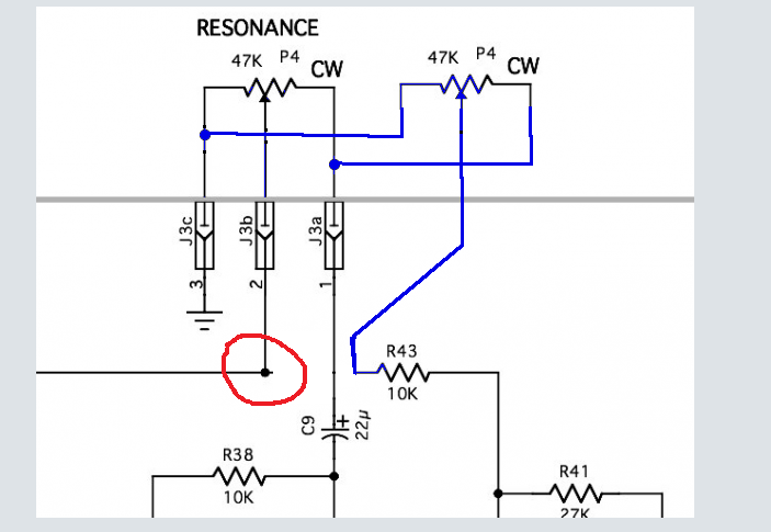

alanwilder81
Joined: Sep 03, 2016
Posts: 310
Location: italy
PostPosted: Thu Jan 26, 2017 6:33 am    Post subject: Reply with quote  Mark this post and the followings unread
thanks Yves,
so, one wire from the wiper goes to the unsoldered left leg of R43.
And the second wire from the wiper goes to the point i circled in red, so that it closes the circuit ,right? Embarassed Embarassed
excuse the dumb questions, i hope i got it right this time ! Smile
 Filesize:  122.55 KB
 Viewed:  368 Time(s)
yusynth
Posts: 1314
PostPosted: Thu Jan 26, 2017 6:54 am    Post subject: Reply with quote  Mark this post and the followings unread
Yes that's correct
Yves
