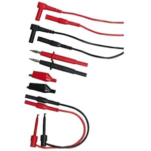

PostPosted: Fri Jul 06, 2012 11:06 am    Post subject: Reply with quote  Mark this post and the followings unread
I use the pin clip attachments on my meter. (the ones in the bottom of this picture http://ecx.images-amazon.com/images/I/41921IJd4yL._SL500_AA300_.jpg)
this actually makes it very easy to walk through a bandolier of resistors, which also keeps them in the same order so I can find the best matching pair when I'm done Smile

PostPosted: Sat Jul 07, 2012 2:50 am    Post subject: Reply with quote  Mark this post and the followings unread
I agree with elmegil, I always use clips, and then hands off when matching resistors.
Keep in mind too that often when matching resistors, it's not that they have to be spot on the value, it's more that they are the same as each other. I get a sheet of paper with a grid drawn on it. Write the nominal figure in the middle square, decimal increments in each box. Then you just use the box that fills up first. Smile
