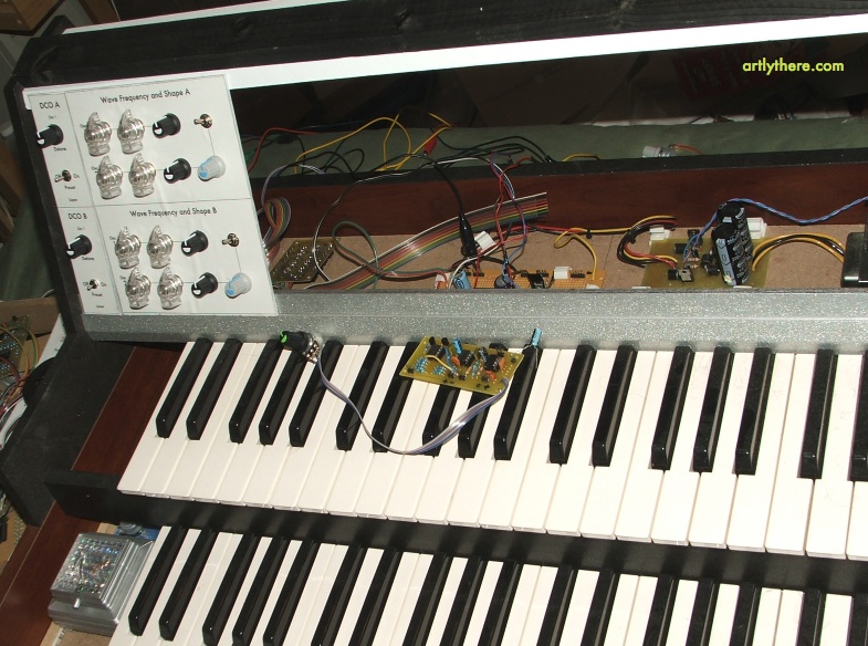

Greetings.
Newbie here.

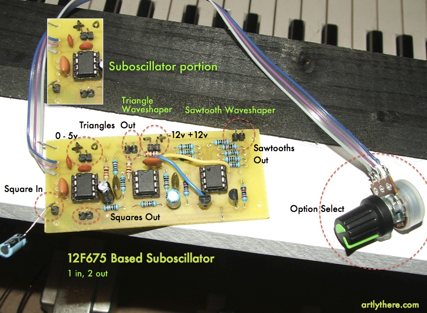

This is still under development so maybe is premature, but...I am building a PICSynth (Kevin Godwin variety, dual) and wanted a suboscillator. Using a flip flop was a usual option, but thought I would try cloning a wave off the main PIC's wave outs into a pin set up for a high/low edge interrupt on a PIC12F675, and then toggle it every so often...voila: Clone-wave sub-oscillator, which works the entire default PICSynth output range. I haven't installed the master waveshaper with octave divider yet but I tink one would want to run this sub from the master outs of the PICSynth chip, because otherwise the subs could end up too low once things divided. On the plus side you end up with easy octaves up the other way, with the main waves set lower.
Since the output of the PIC is a square, I then added portion of the wave shaper for the PICSynth (integrator) to get (sort of) a triangle, and then used Nicolas Woolaston's tri+square-> sawtooth shaper in combination to get something that's more than a square out.
I'm probably killing something the way I have it set up because I have not much idea what I am doing, am big-time op-amp newbie, but it works and sounds alright so far. The sample mp3 is very thin (not much bass) due to the RadioShack mini amp I used, and then that going into a digicam which would have thinned it out anyway.
It's only a single PIC12F675, a 20 MHz resonator, a 10k pot set up Electric Druid style, a couple capacitors and a resistor basically for the suboscillator itself. The wave shaper and that I have it set up for two waves there is what adds the complexity. You can see how small the basic subosc is in the small inset.
I have a pot to adjust options using the PIC's analog input,
The ranges are software delimited as so (currently):
0 is off
1 is both outs as input clones (over-drives the output)
2 is 1 as clone, 1 @ 1 octave down
3 is 1 @ 1 octave down, 1 @ 2 octaves down
4 is 1 @ 1 octave down, 1 @ 2, then a 5th back up
5 is both at 2 down, a 5th back up
6 is 1 at 2 down, the other at 2 down, 5th back up
7 is...1 at 2 down a fifth back up, then another that's same, but way on down...
If you toggle a pin every 1st, 2nd, 3rd, 4th, 6th wave in, that's what it does in various combinations.
The saw out is more a shark fin, but it sure sounds cool. With both saws going, it really sings (didn't have both hooked up, I think the sample was one square, and one saw)
I am currently applying the same notion with a larger and faster PIC to clone out a true add-on frequency tracking oscillator (including software PWM, no filter needed) with individual detuning and octave shifts up or down. Since you are tracking the main oscillators, it will also auto-add any main-oscillator's portamento yet still change with the regular keyboard.
Could work with any oscillator outputting a good clear high/low edge I'd think.

Hi, I am not sure yet, but otherwise I need to make sure the last setting is correct. I might have a little glitch in the potentiometer code, perhaps the ADC timings are off, but generally it works perfectly.
I use PICSimulatorIDE from Oshon Software http://www.oshonsoft.com/pic.html. Works nice for such as this, and you can simulate things fairly well, saving a lot of false starts.
