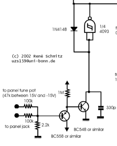

In this schematic is an interesting sawtooth vco made from a 4093 NAND chip.
It is more or less v/oct. And for high frequency, so the 330pF timing cap should be lowered...(I used an LED instead of the diode).
http://www.schmitzbits.de/
(Three-Phse-LFO)
But the diode thing rules for simplicity! Shocked
EDIT:I just realized that lunettas use single supply(here dual for exp.converter),
but interesting nonetheless Wink

PostPosted: Mon Feb 17, 2014 9:34 pm    Post subject: Reply with quote  Mark this post and the followings unread
Eliminate the PNP from the Rene Schmitz VCO and it will be single-supply. The response won't be V/Oct and probably not Oct/V, either.
I favor replacing the diode in the feedback path with a resistor or pot. That should give a more square-ish waveform, instead of a spiky saw.

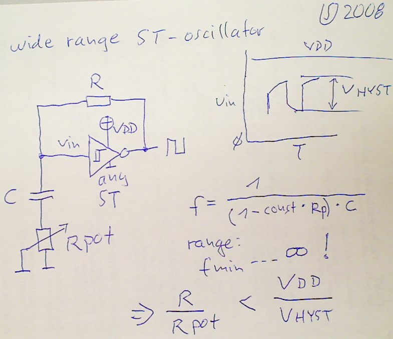

This has NOTHING to do with voltage control at all !
Proof: disconnect your V+ power supply from the potentiometer and GND lboth ends of the potentiometer.
I claim the "pseudo VCO" -behaviour will be the same without CV Smile !
this circuit is a tricky variant of the standard ST-oscillator. I spent quite a
lot of time to figure out how it works when I discovered it ( I don't say that I invented it, just that I stumbled about it a couple of years ago, and I did not see it somewhere before) :
with Rpot = 0, it is the well known standard oscillator.
If you rise Rpot it forms a voltage divider with R : a part of the output squarewave is fed back to the input and linearely overlays with the "triangle" voltage from the standard operation. As a consequence of this,
the" triangle" reaches the ST-thresholds much faster and the frequency rises.
Obviously there is a limit: when the fed back squarewave reaches ST-threshold voltage, frequeny would be infinit and the circuit stops working. So R / Rpot must always be smaller than V+ / Vthreshold !
Thsi circuit has some nice properties :
1) the tuning range is much higher than the standard circuit ( see graph)
2) it has a "closer to exponential" tuning range (see graph), which makes it interesting for sound generation.
3) the potentiometer is grounded and free from DC which makes it easy to replace by grounded sensors ( like Richard has shown with the VC-diode circuit above)
So why is it not popular ? :
the killing drawback is its terrible sensivity when you rise Rpot close to
the limit. The remaining triangle part of the input voltage becomes smaller and smaller and you get really LOTS of jitter and noise modulation.
But for Lunetta-style sound gadgets it can be a good solution.
the graph shows 3 tuning ranges:
a) standard ST-oscillator (Rpot =0)
b) perfect theoretical exponential tuning
c) wide range ST-oscillator ( Rpot << R )
have fun to breadboard it Smile

PostPosted: Tue Feb 18, 2014 9:49 am    Post subject: Reply with quote  Mark this post and the followings unread
I just tested it and you are correct, well actually I get a slightly larger range with the pot connected to GND at both sides. You can also leave
one side unconnected. I did another test connecting the capacitor to the output of an opamp configured as a voltage follower, doesn't work.

PostPosted: Tue Feb 18, 2014 4:19 pm    Post subject: Reply with quote  Mark this post and the followings unread
you are right. when I feed the cap from an opamp voltage folower it loose the vco effect almost. the change in frequency is verry little then.
maximum effect is attchieved this way by using a high cap (1uf) and a very low R1 : 1.5 octaves, and the change in frequency is reversed then.

PostPosted: Wed Feb 19, 2014 12:23 am    Post subject:   Reply with quote  Mark this post and the followings unread
That is not really a proof though for the original circuit idea not working
why don't you believe in physics ( a C blocks DC, period) ?

It´s a pity though. Any idea how to get a more exponential response of the diode to ground idea? I mean it should be exponential aready, just not very precise...
And the resistance of the diode is only changing over 0V- ca.0,8V, is that right?
that sounds pretty good Very Happy what flter did you use ?
That one:

Now I´ve tasted blood...
Twisted Evil
Think I´ve got to look into 4093 vco module!
It´s not lunetta, so I´ll take my hat here, with one more clip for you Laughing
4093 vco.mp3

I´m tending to the cv-way explained by richardc64, diode to ground (while vactrols are nice, I need them for my vcf´s already).
I´m thinking about and will be trying soon if it is possible to use bipolar cv in a scheme like the Steiner VC Phaser circuit...
