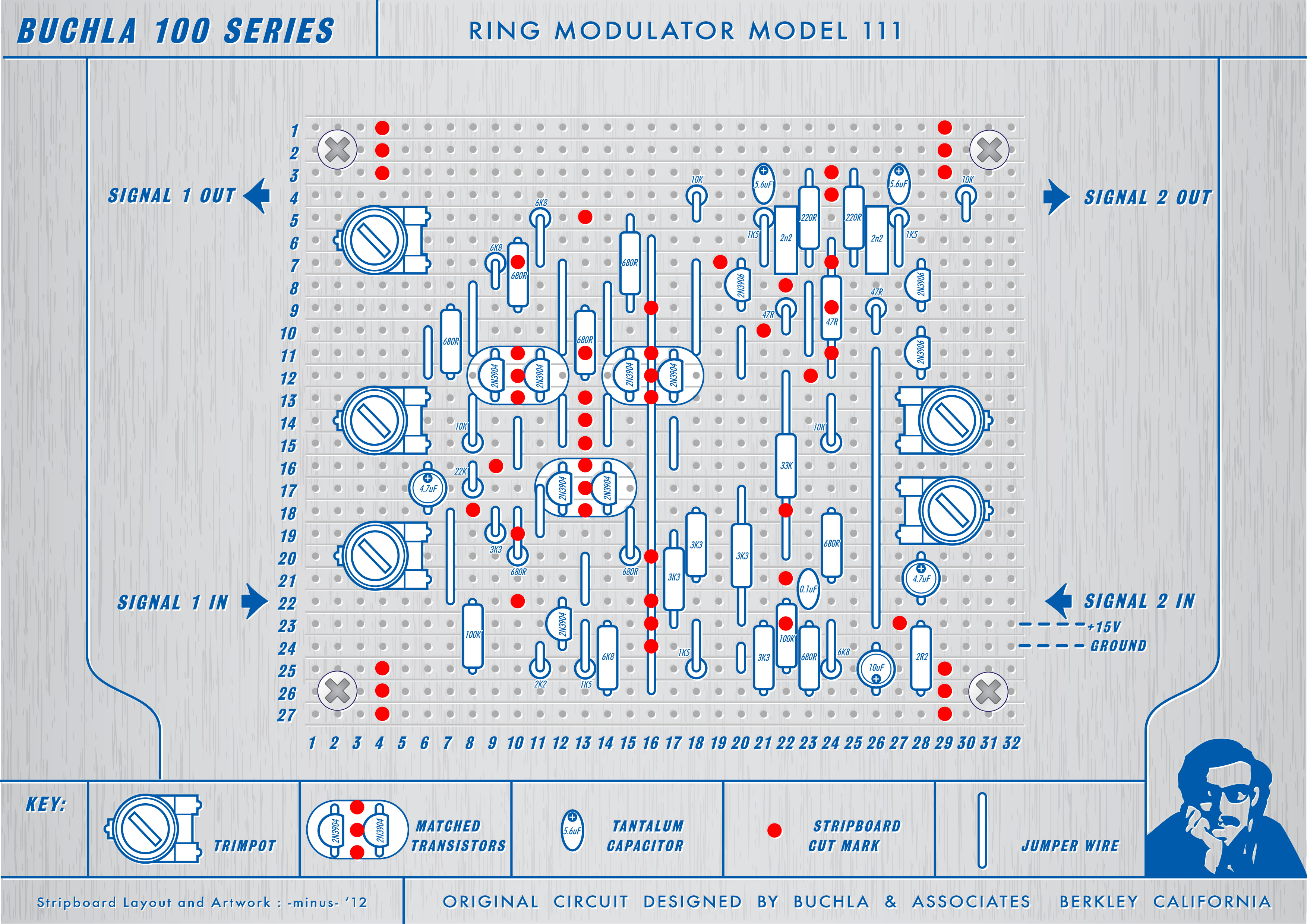

I stripboarded the 100 Series Buchla Ring Modulator from the discussion and schematics found in this thread:
http://electro-music.com/forum/topic-35574-25.html&sid=404eafa91e830ceed29f68c0cd61a18b
During construction I went on an extreme Buchla tangent and haven't been the same since. Laughing I have been astounded by the brilliant design and elegant typography found on the Buchla panels. Just look at those fonts! I cannot honestly think of anything which comes visually close to this, synth or otherwise. This stuff is seriously in a league of it's own, as are the modules themselves.
So here is the diagram... I have built this and it works. It seems to run on 12V fine, but on 15V as labelled in the original schematic, it will give you goose bumps! This is a nice circuit indeed. I spent an hour trying to figure out the trimming. Without data on how to do this, I ended up playing around until it sounded good (to my ears). It's not the dual version as the original was, but it would be easy to make another. I tried to put the matched transistors as close together as possible. You can glue them together if you are concerned about temperature and stability. MFOS has information on this here:
http://www.musicfromouterspace.com/analogsynth_new/TRANSISTORMATCHER/TRANSISTORMATCHER.html
I used 2N3904 and 2N3906 throughout. You definitely should socket the transistors for this one. I matched mine on a breadboard using this simple circuit:
http://electro-music.com/forum/post-276867.html
It's the Yusynth one... 3rd post down.
I used 6.8uF tantalum caps as I couldn't get the 5.6uF ones. Also, you could use a ferrite bead in place of the 2.2 Ohm resistor at the power input. The board has been laid out to accommodate a variety of trimpots: Horizontal (as illustrated), Vertical, Piher Style, 25 Turn Cermet etc.
I shall post a sound clip or two in the coming days. Happy Buchla building!

PostPosted: Thu Oct 25, 2012 10:20 am    Post subject: Reply with quote  Mark this post and the followings unread
Nice Smile
How important is it to have Tantalums as opposed to other high quality film-type caps? I don't know that I have any that big anyway, but figured I'd ask since I have avoided Tantalum as much as possible after hearing stories about magic smoke even if you look at them cross eyed Smile

Good question, but I don't know the answer. Laughing I have read they can self-destruct but in the couple of times I have used them I've never had a problem. Perhaps you could just substitute electrolytic capacitors, say 4.7uF. There is enough room to extend the two 220 Ohm resistors up a rail and have room for caps across three hole. I was short two trimmers and had to steal from my breadboard. I'll hook up some rotaries there and do some experiments with different capacitors.

Last question : size of the trimmers?
-minus-
Joined: Oct 26, 2008
Posts: 787
PostPosted: Sat Jun 21, 2014 7:51 am    Post subject: Reply with quote  Mark this post and the followings unread
Trimpots... Don't you hate that. I can't believe I have forgotten to mention the values there. I'll have a look at my board right now....
OK. The one on the bottom right is 20K. All the others are 1K.
Sorry I neglected to label those. I shall have to fix that up on the illustration.

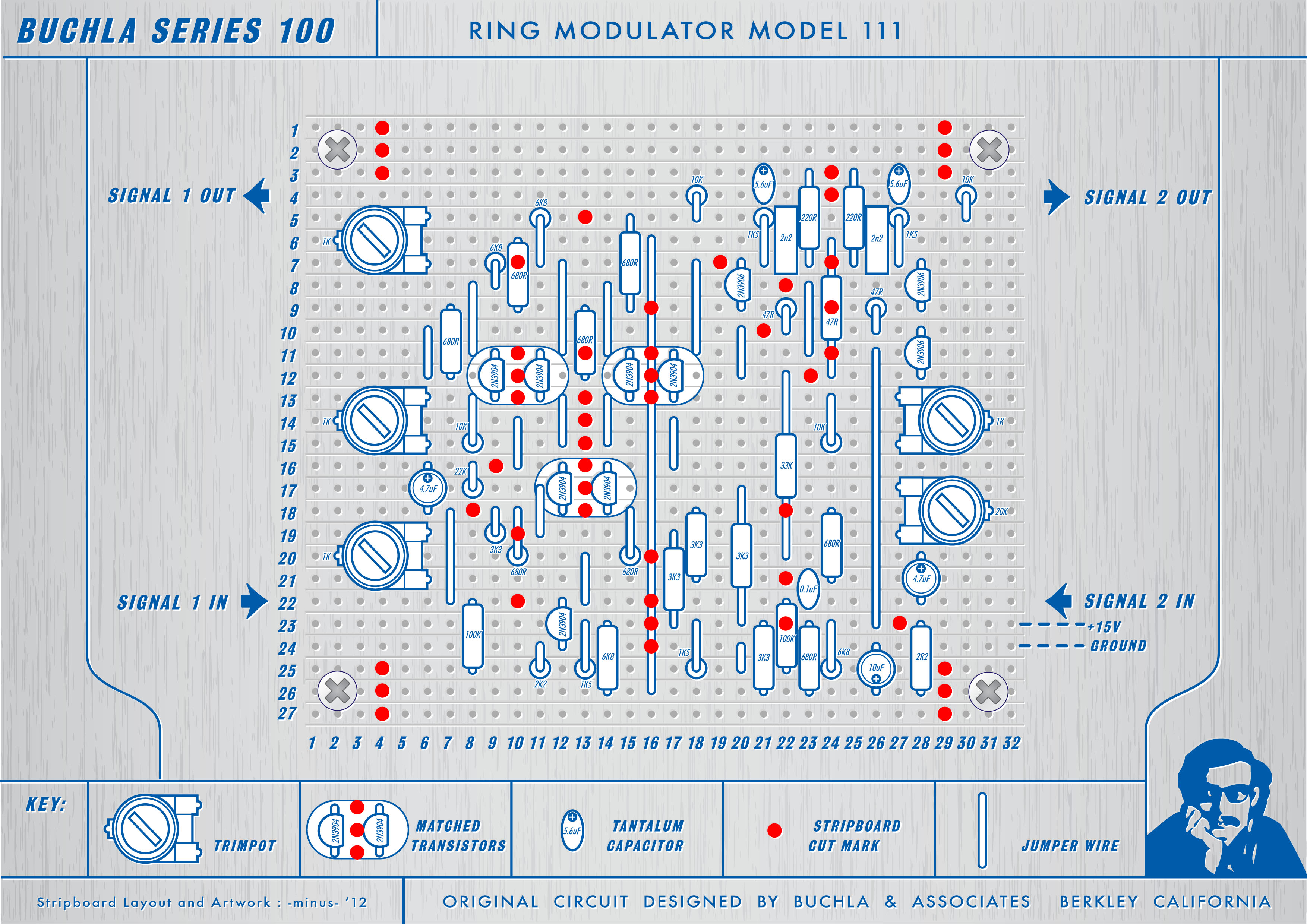

So here is the new version with correct trimpot values...
NOTE:
On the original Buchla schematic there is a missing value for one of the trimpots. On the first link I posted at the top of this page there is a pcb layout. I used a 20K the same as in that link above.
V3: Added the trimmer values.

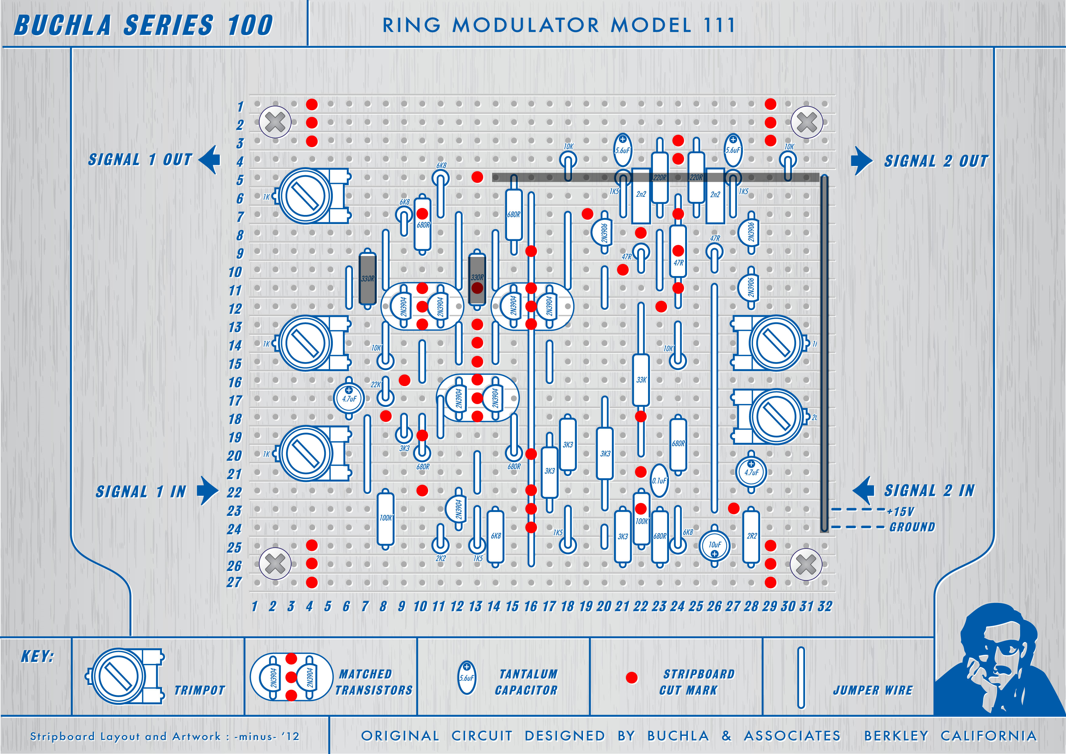

Not sure it makes a big difference but i noticed two small mistakes in the layout:
- the highlighted row should be tied to ground.
- R5 and R6 should be 330R instead of 680R.
The output is very low, this modification suggests to change few resistors and adding an opamp (in my case changing those resistors was enough without any addtional opamp) : https://modularsynthesis.com/buchla/111/111%20Schematic%20modifications.pdf
