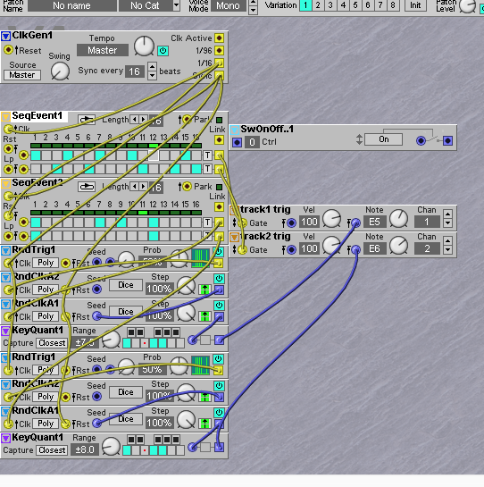

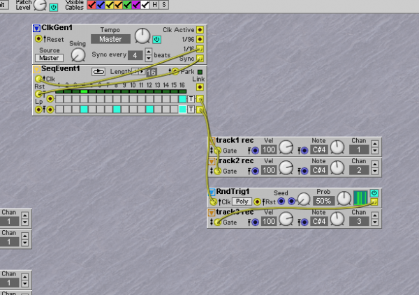

Attaching a couple of screenshot of how it looks in the G2 editor when controlling the Octatrack, and an excerpt from a simple noodle that I was messing around with. The noodle sends a tone to the Octatrack that is regularly resampled using random trigs, and some randomized bell sounds that are looped on the Octatrack. The bell sounds are also regularly resampled.
The sampled tone is used by two tracks that are trigged chromatically from Nord sequencers, making up a kind of randomized sequence.
You can do a lot more advanced stuff with this setup - this is just my first test attempt. I probably will explore this path more in the future.

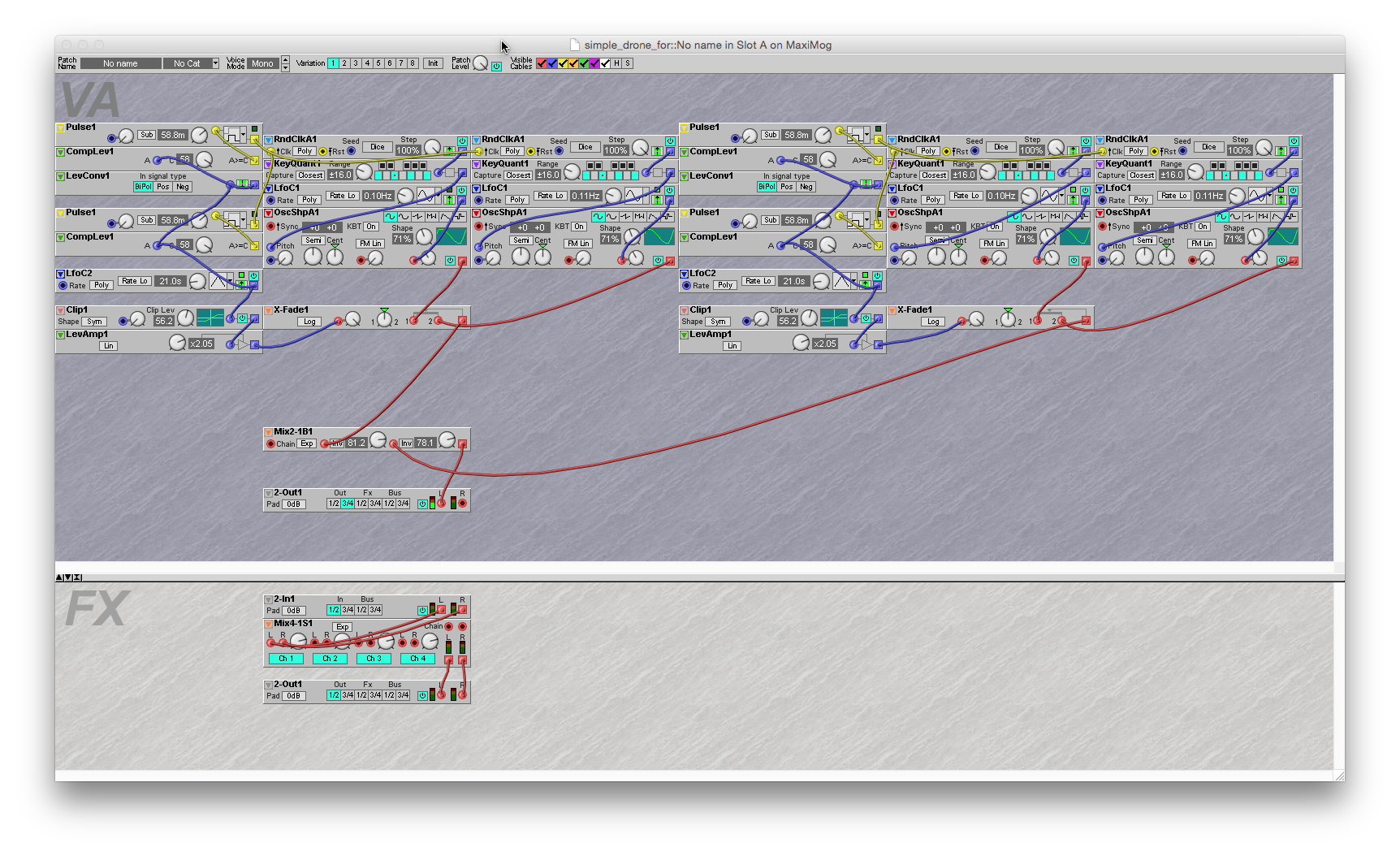

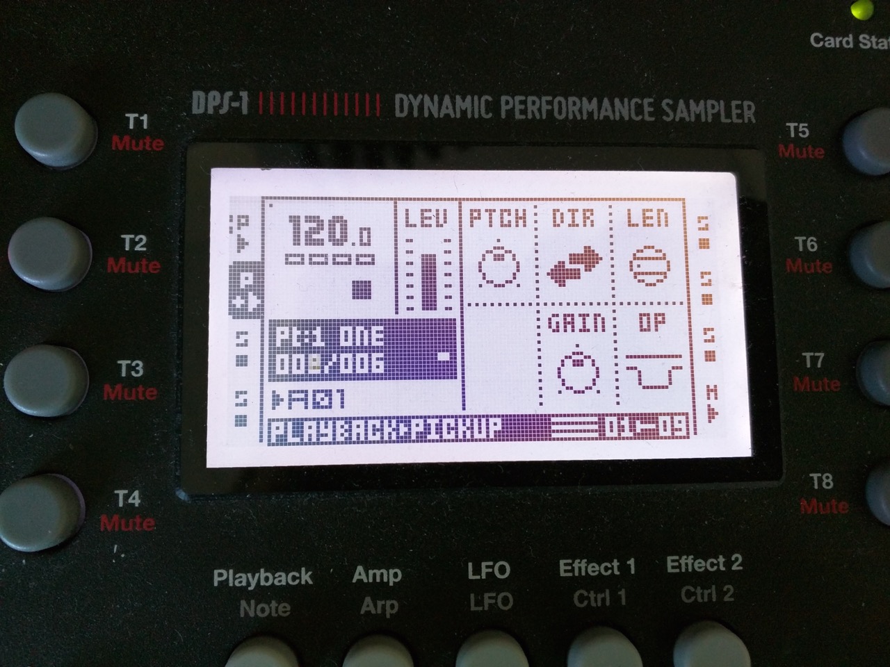

I wanted to try something a bit more ambient, so I read up on the pickup machines on the Octatrack, who I've never really gotten a grip on. I think I understand them now. Pickup machines are basically a way to do live looping, overdub etc, that you can't do easily using the other tools in the Octatrack.
I was planning on introducing some MIDI, but I thought it sounded nice when I just triggered the pickup machines by hand, so I made a recording of that.
So this is a simple drone thing on the G2 (the whole patch can be seen in the screenshot), moving between notes in a Cmaj7 chord. It gets mixed into one output that goes into the Octatrack, where two pickup machines listen to it. I trigger each pickup machine by hand to either record, playback, overdub, or stop. The pickup machines are set to play back in ping pong style, meaning the play back their sample normally, then reversed, then normally and so on. One pickup machine records and plays six bars, the other eight bars.
I've put a compressor on everything in the Octatrack - it can get loud sometimes when you overdub.
