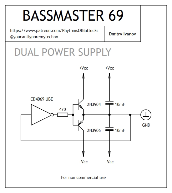

Hello, ixtern!
I will post here some of my tested cirsuits. Now I see, that it will be two more versions of BassMaster:
- BassMaster 74, TL074 based synth, +/- 12V;
- BassMaster 69, CD4069 UBE based synth, +/- 6V;
All of them will have the cheapest MT3608 DC-DC step up converter.
ATTiny 85 tested with exponential V/Oct table, and it's working fine. I only still can't make any good sounding LPF. It's possible to replicate Moog's transistor ladder LPF, but it's not my goal.
Here are some new circuits of BassMaster 69:
Dual power supply
 Filesize:  96.68 KB
 Viewed:  668 Time(s)
VCA
 Filesize:  112.59 KB
 Viewed:  637 Time(s)

I got carried away with sodering... BassMaster 69 is fully analog, with CV/Gate interface.
Video:
BassMaster 69 circuit diagram
 Filesize:  434.29 KB
 Viewed:  861 Time(s)

PostPosted: Wed Aug 22, 2018 1:48 pm    Post subject: Reply with quote  Mark this post and the followings unread
Nicely simple electronics - I love that thyristor osc thing .. that must be about as simple as it can get Cool
nice tune too Wink
