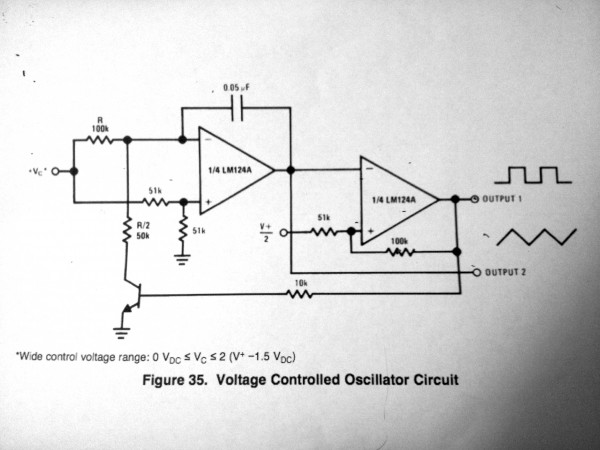

Hi everyone, congratulations on this beautiful forum. This is my first post here, but I have been acquiring a lot of knowledge by just reading other people's threads so far.
Now I want to design my own VCO. I think my understanding of electronics is getting good enough to do it... with help of course Smile My design won't be perfect but I don't mind a bit of glitch and building from the ground up will surely teach me a lot.

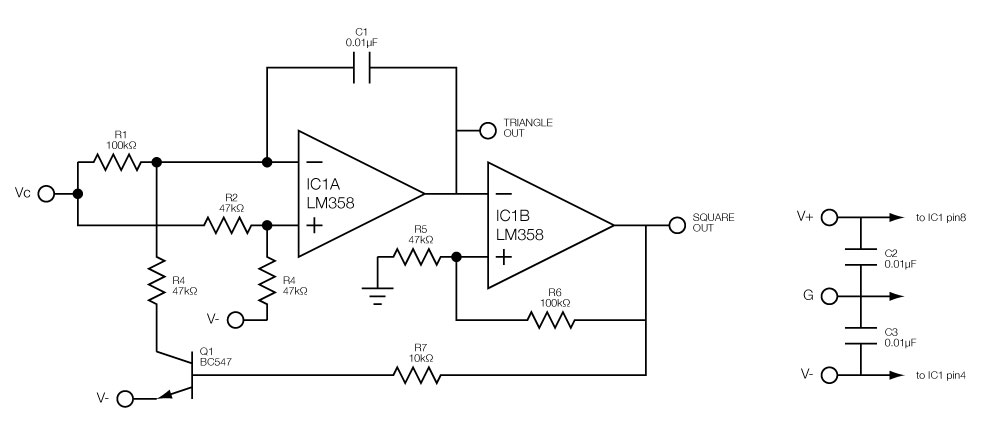

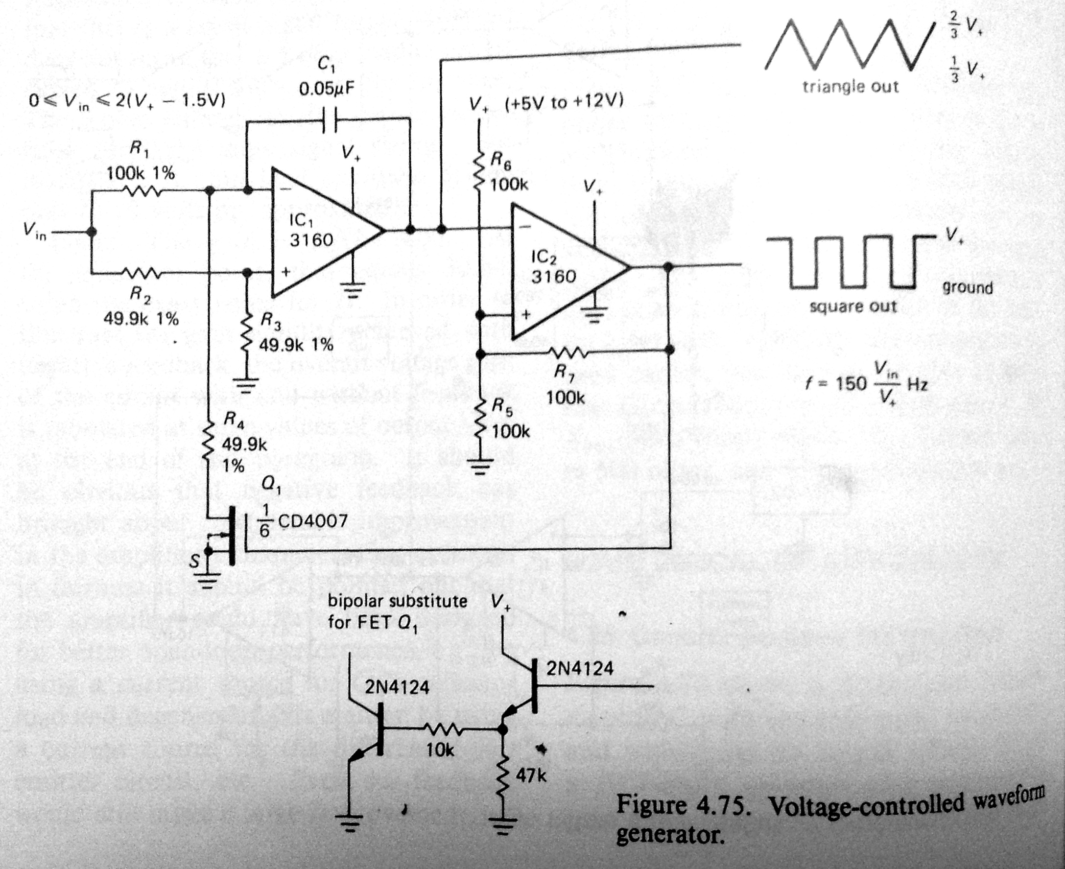

So the starting point of my VCO is an integrator / schmitt trigger. I found it on the datasheet of Texas Instruments for the LM124 (p.17) and I recently came across it in the book The Art Of Electronics. It also seems to be the heart of Thomas Henry's VCO-1. I want to make sure I really understand what's going on in those schematics before I start adding to it.
Attached are both the TI and the AOEE schematics. Two things strike me:
1. The 49.9K resistors in the AOEE book are replaced by 51K resistors in the TI datasheet. Why is this? Which option is... better?
2. In the TI schematics there is a BJT with a 10K at the base to "relax" the inverting input of the integrator and allow the cap to discharge. In the AOEE they use a FET with no resistor at the gate and provide a more complex circuit made of two transistors if you decide to use a BJT.
3a. I have built the TI version and I know it works. But I understand that the FET seems to be a better option as it is voltage driven and the op-amp will output mostly voltage and almost no current. Is this right? Why does the TI version even work?
3b. In the AOEE alternative BJT version they use two transistors. Are the basically just amplifying the signal?
Thanks in advance!
R4( references from AOE book) must be exactly 1/2 of R1 to get a symmetrical triangle. I always use 2 pcs.R1 in parallel for R4, or 2 pcs. R4 in series for R1, because then you can choose any standard R value (47k...220k). The same value can be used for R2 and R3 and also for R5,6,7 - then it's simply 1 value for all Rs to get the best precision.
for small currents like here , the CE saturation voltage is only some ten mV, which does not do much concerning symmetry. The circuit can be improved by swapping C and E of the discharge trans. and tweaking the 10k base resistor until you get <2mV Vce-sat. I don't see a reason to use a a second transistor to buffer the comparator because the 3160 can easily drive >1.5 mA, which is required here. A discrete MOSFET can be used instead of the 4007 or a 4066/4053/.... analog switch if you prefer ICs.
The circuit would even work with a diode as discharge switch ( symmetry/linearity not so nice then ...) or use a true comparator with OC like LM339 to get rid of the extra discharge switch.

robynm wrote:
1. I did a simulation of the circuit with C and E swapped and the triangle's amplitude increases. Why is that? I thought that C always had to be the positive side and E the negative.
this should not be and I didn't see it when swapping C and E in your linked example !?? In fact you will see nothing in these tiny simulation windows, because we talk about some mV difference in a some-volts signal.
You can swap C and E with any transistor and it will still work with the disatvantage of a very low (reverse-) gain and the advantage of a very low saturation voltage.
robynm wrote:
2. Also, in the Art of Electronics, there is no resistor between the 1/2 V+ and the non inverting input of the schmitt trigger. ..
there is one : it is R5 parallel R6 . When you replace the voltage divider R5,R6 connected to V+ by R5 parallel R6 connected to V+/2 you will have an equivalent circuit with the same internal resistance.
robynm wrote:
3. I am trying to learn circuit analysis because there is no way around it. Kirchoff is still causing me trouble but I'll get there. Is it out of reach for me to understand how they come up with this equation to calculate the frequency?
don't worry:
1. calculate the upper and lower switching thresholds of the comparator:
if comp. Vout is v+ then R7 is parallel to R6 and the voltage over R5 is 2/3 V+
if comp. Vout is 0V, then R7 is parallel to R5 and the voltage over them is 1/3 v+
2. calculate the output voltage range of the integrator :
amplitude of the triangle is upper minus lower threshold = 2/3V+ - 1/3V+ = V+/3
3. calculate the current that fills C1 :
let comp. Vout = 0 => Q1 is OFF => integrator is ramping down
constant current flowing into C1 == current flowing through R1
noninverting input is held @ Vin/2 so opamp keeps inverting output also @ Vin/2
Ic1 = Ir1 = Vr1/R1 = ( Vin - Vin/2)/R1 = (Vin/2)/R1
4. calculate output voltage ramp (absolute value, sign changes for up/down ramp) of the integrator:
down from 2/3V+ to 1/3V+. Lets calculate the time for this ramp:
voltage change in a capacitor is high when the charging time is high, the charging current is
high and the capacitor is small. here:
deltaV = (Ir1 * Tramp) / C1
because deltaV is the ramp amplitude and Ir1 = (Vin/2)/R1 we can write :
deltaV = V+/3 = (Vin/2)/R1 * T / C1
5. calculate the ramp time T :
T = ( 2 * V+ * C1 * R1) / ( 3 * Vin )
because 1 periode is 2 ramps (up&down) frequency can be calculated as:
f = 1/(2T) = 3 * Vin / ( 2*2 * R1 * C1 * V+)
with R1 = 0.1e6 and C1 = 50e-9 you end up with the formula in the schematics:
f = 150 * Vin / V+

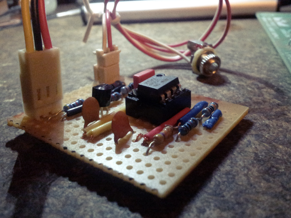

PostPosted: Fri Dec 06, 2013 12:35 am    Post subject: Reply with quote  Mark this post and the followings unread
OK So I have finally finished the core of this VCO and soldered it to stripboard. It works a charm and I am really happy. I've even breadboarded a Baby 8 sequencer to make it sing. I felt like a dad hearing his kid say his first word Smile
Now I would like to give this thing a bit of range because so far I can only go from about 333Hz to 666Hz corresponding to a 12V range in the control voltage.
From what I've gathered looking at other VCOs and reading numerous articles, what I need is to convert this voltage into current with a transconductance device. That would allow me to control the amount of current that charges C1 and get the maximum range?
I want to keep things dead simple and avoid using an OTA for the moment because I want to learn how things work (otherwise I would just build Thomas Heny's VCO-1 right away).
It seems that FETs are voltage driven and control a current. Can I just implement some sort of FET amplifier at the input of my existing VCO?
