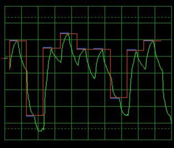

This is what I'm trying to work out now. In the attached pic the blue lines represent the times that the signal is moving towards one of the voltage levels on the divider (ie, one or more switch in the 4066 is closed) Where the blue line stops, the signal starts to move towards 0V.
My question is why are there gaps between those times? If there weren't, the wave would look a lot more like the red line, which is what I'm really chasing.
First I thought that the 4066 takes longer to connect a switch than to open it. But according to the data sheet the propagation delay for 9V operation is about 65ns for both low-high and high-low control signals, which is way to fast to be seen at audio frequencies (~15Mhz?)
So the next suspect (should have been the first) is the speed of the diodes. (And as you said Jan, their associated capacitance) I've looked at the 1N4148s data sheet but it only quotes the reverse recovery time, which is down around 4ns anyway.
I'll keep experimenting, and let you know if I find an answer. I'm going to start a stripboard layout of the DIL switch version so I can play with other waveshapes too.

The scoop shots have been puzzling me as well . ... it's as if the DAC is only driven half the time. From what I've seen in the schematics sofar I've no explanation for it.
How do you control the switches in the diode matrix, could there be something wrong with that circuit ?
What speed are you running the main oscillator on ?

Is you Winscope performed with your sound card? In that case, I imagine it may be AC coupled, and it would not 'hold' a DC level, but move back towards 0V once the level became stationary.
The best way to trouble shoot it would be to pulse the input slowly, step by step, observing what comes out of the DAC.
Is it possbile to post a schem of how you have things right now?

I'm still pretty useless trying to use Ray's schem publisher so I'll try to describe it. It's basically the same as the first drawing in this thread, except I've added a 220nF de-coupling cap followed by a 10K volume pot on the output, and there are 5K pull down resistors on each 4066 control line. The control lines are fed by 10*1N4148 diodes on various 4017 outputs to combinations of 4066 control lines.
Yes the winscope goes into the soundcard, but there's definately a point where the signal stops heading towards the expected output, and starts heading towards 0V. I'm sure that means the 4066 switches aren't staying on long enough.
If I crank up the main frequency the trace shows much straighter lines from one voltage level to the next.
Thanks for the ideas anyway, I'll keep on the case!
PostPosted: Sat Feb 18, 2006 8:41 am    Post subject: Reply with quote  Mark this post and the followings unread
Taking the de-coupling cap out flattens the tops a lot, but at low frequencies, it still just looks like a lot of different sized spikes. It's like the 4066 switches only stay on for a brief moment.
I'm starting to think you're right Scott. Some kind of capacitance effect is allowing the signal to bleed back to 0V. It doesn't get enough time to at higher frequencies. The question is, how do I "hold" it, at least down to say 200Hz?

In this case, you might try avoiding any capacitance and probing on the DAC output itself without buffering. Isolate the DAC with a buffer and do all of that stuff downstream from the buffer. A TL07X set up as a voltage follower will work fine for that. Connect the output of the dac to that, and just do all of your coupling and probing on the output of the buffer.

I reckon the bits where the signal moves towards 0V are points between steps where the last steps switches haven't dropped out yet. Almost every time this happens, there will be a small moment when too many switches are closed. (closer to 0V)
So I'm thinking that the capacitance of the diode matrix is holding the 4066 switches up just a bit too long. Now, could that be helped by putting pull down resistors on the 4017 side of the matrix (ie: 8 of them) instead of, or as well as on the 4066 side (ie: 4 of them)?
I'll get back home tonight and try it out.

I found the problem!!! Very Happy
A very screwy method of getting a square wave out of a 555 which was contaminating the supply rails something shocking. (I forced all the 4066 control lines low so that no switching could happen, the output still showed a whopping big spiky square wave at the main frequency)
Now I've put a 220uF smoothing cap on the supply and incorporated a 10K/4n7 LP before hitting a TL071 voltage follower.
Here's a pic of what's coming out now. A bit of overshoot, and a touch of switching noise, but it's 500% better than before.
I'll re-do the pulldown experiments tonight and see if it improves. Cool
