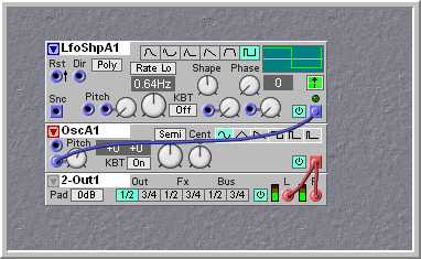

Great point about the subtile mistracking and voltage jitter. There was also hum, noise, and distortion in every module. Also, as I discovered just recently when I started playing my Moog Modular after several years, there were weirdnesses when the voltage controlled modules were driven beyond their design limits.
When I was demonstrating the G2 to Zynth a few days ago, see: http://electro-music.com/forum/topic-1597.html, I set up a very simple patch: a sine wave of constant frequency (about 500 Hz) and amplitude being modulated by a sub-audio square wave of constant frequency and amplitude. This gives a two note tone.
Each transition of the frequency of the sine produces a small click. On the G2, there was a tiny difference in the sound of each click and this seems to cycle through about every 6 or 7 transitions. At first I thought this was a bug in the G2, but then I realized is was truly an artifact of the patch. On the G2 the oscillators are rock steady, 24 bit at 96 KHz. The clicks sound different because the modulation is changing at a different point in the sine's phase each time. The square and the sine are probably related by some factor of 6.
I set this up on the Moog after Zynth left and you can't hear this because
1) there is some slew in the square wave
2) there is some slew in the pitch change of the sine
3) the frequency response of the Moog is considerably rolled off compared to the G2
4) there is frequency instability in the two oscillators
5) there is a lot of hum and noise to listen through.
Like you say, I could patch the G2 to emulate all these errors.
