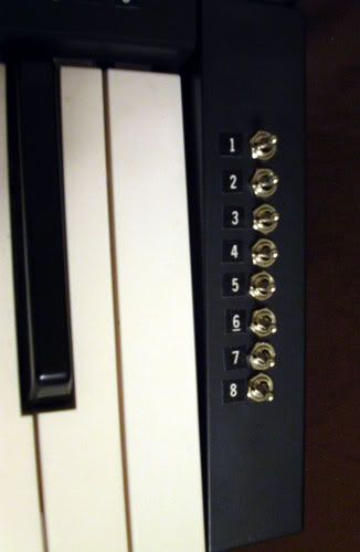

mister
Joined: Jun 06, 2006
Posts: 11
Location: Washington DC, USA
Audio files: 6
PostPosted: Fri Jun 09, 2006 6:13 am    Post subject:   Reply with quote  Mark this post and the followings unread
THANKS DNNY!
After 14 hours of work I have finally finished my PSR-6, complete with new paint job. I'm calling it the pisser. I will post pictures as soon as their developed. Everything is functioning wonderfully and your right, the possibilities are endless! I especially love the sounds I can get from the rhythms. When in this mode glitching it out produces awesome rhythmic distortion and noise.
I remember playing this thing through an old guitar pedal and it beefed it up a lot. So I'm going to try and wire and mount an old distortion or phaser pedal into the housing. Should be a simple task in terms of wiring, but the mounting will take some thought. Any ideas or suggestions in this matter. Perhaps a cheap pedal you'd recommend.
BACK TO THE GLITCH PISSER I GO!!!!!!!
mister
Posts: 11
Audio files: 6
PostPosted: Fri Jun 09, 2006 9:19 am    Post subject: Reply with quote  Mark this post and the followings unread
pics of the gLitCh pIssEr

dnny
Joined: Mar 12, 2005
Posts: 519
Location: Helsinki, Finland
PostPosted: Fri Jun 09, 2006 1:33 pm    Post subject: Reply with quote  Mark this post and the followings unread
NICE . really nice . i love the way you have the LED monitor switches and the patch points in rows.
is the one extra switch for the monitor on/off? or what?
could you write some hints for the switch positions and what exactly you made to get the rhythm section flip. or maybe some guidelines even. that would be great and make this thread even more informative for someone who might want to bend Yamaha PSR-6

mister
Posts: 11
Audio files: 6
PostPosted: Mon Jun 12, 2006 5:42 am    Post subject: Reply with quote  Mark this post and the followings unread
yeah that's what it for, yes.
the pin controls (IE:switch, monitor light, patch points for each pin) are not ordered from 0-1. I put them in my own logical order starting with 4 because it is the pin responsible for triggering sounds (thanks to you I know this Wink ) I've written down some "patches" and I'll let you know more ASAP. here's what I remember at the moment.
patch pin CPU pin 4 to FM pin 5 (or vice versa) and turn off 4's switch (or 5's switch). now play around with different presets. I get many of them to create some sort of split pad, where the first 2 octaves had a bass tone and the last two made some random pad or higher pitched sound completely different from the bass tone. sometimes it makes a difference which pad your on when you make the patch and switch flip. this is also the same type of patching I made when playing with the rhythms. it allowed me to, in some cases, turn certain aspects of the beat on/off by using switches 2-5. and when in fingered mode flipping specific switches and than switching patches will change the tones being accessed.
my best advice to anyone who makes this machine is to play around. learning the PSR-6's personality first hand is fun and will insure that you remember the processes in creating your sounds. also it will give you new ideas that we've never thought of!
I recommend this instrument to anyone who finds one. everyone has seen bent casios but there arn't many times you see these and I like the sounds of Yamaha better any who. Again thanks for the advising DNNY.
