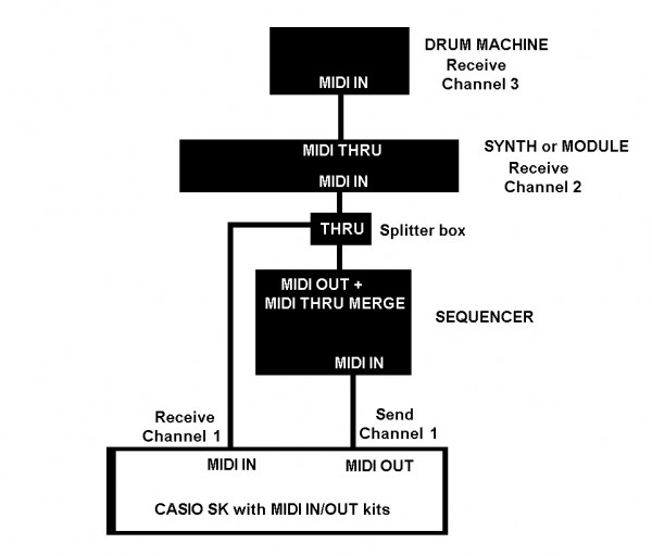

gmeredith
Joined: Jun 28, 2006
Posts: 82
Location: Tasmania, Australia
PostPosted: Sun Aug 27, 2006 8:19 pm    Post subject: Reply with quote  Mark this post and the followings unread
Hi cOnsumer,
As such, with the setup you are describing, if you used a device to trigger a note on the SK-1 (using IN) it would also register as a note on OUT, potentially creating a loop.
I don't see the problem with that, really. ANY MIDI keyboard sending on the same channel as it's receive channnel will have this problem, if its MIDI out is connected back into its MIDI in, through a device, such as a sequencer, for example. I already get this with my Casio FZ-1 sampler and my sequencer. You simply either change the receive channel while your using it to control another keyboard or playing into the sequencer, or turn the volume off while your recording the other synth, or use the MIDI OUT/THRU merge facility on the sequencer. You could also make a simple MIDI mute switch on the MIDI in port. Lots of ways to overcome it. It honestly isn't a problem, that's what happens with all MIDI keyboards.
Cheers, Graham
or maybe just run them on separate channels. But that would be inelegant.
No, not inelegant, that is how it is actually done. That is how I use my FZ-1 as a master keyboard.
Let me explain the scenario a bit more, with a diagram (see below):
The Casio SK MIDI IN Kit by "Highly Liquid" that I have installed in my SK8, and which you are basically making also, gives you the option of changing the MIDI receive channel.
If you now made a MIDI OUT board that you could also select the MIDI out channel, you could have the MIDI send set to channel 1, say.
Now, have the receive channel set to 1 (don't worry about the feedback issue - just follow my thoughts for a minute).
Look at the diagram below to see the setup you might use (this is the setup I presently use).
Firstly, set the Sequencer OUT/THRU MERGE to OFF (my MMT8 sequencer has a switchable port merge feature, as do many sequencers and software sequencers).
Start off recording the SK's notes on the sequencer on channel 1.
Play back the sequencer, to hear what you just recorded. The SK plays, but no feedback occurs, because the signal that comes out of the sequencer goes into the SK, then into the sequencer again, but does NOT come out of the sequencer's OUT port again, because the OUT/THRU merge on the sequencer is OFF.
Now, set the SK OUT to channel 2, and switch the Sequencer OUT/THRU merge to ON. Play the SK. You should hear the synth module play. You will also hear the SK, because you are playing its keys, if the volume is up, but you will not get feedback, because the SK is sending on a different channel than its receive channel.
Hit PLAY on the sequencer. You should hear the SK playing. Hit record on the sequencer. Record the synth module line on channel 2.
Hit Play. The SK AND the synth module will play on their own channels.
Do the same for the drums on channel 3. Play it back. All 3 should play. Now, the only time you'll get feedback is if you set the SK's SEND channel back to 1, and have the sequencer MIDI OUT/THRU merge switched ON. Any synth with an OUT and an IN will have this issue under those conditions. But then, all that you do is switch the OUT/THRU merge on the sequencer to OFF.
Like I said, this is how I already run my system, with my FZ-1 sampler in place of an SK. It gets MIDI feedback if you set the send and receive channel the same, and the sequencer OUT/THRU merge is ON. So it would not be a problem unique to your SK MIDI OUT board, if you built one. And certainly not an issue in my setup, especially if the MIDI OUT board had its own MIDI channel select.
Hope that made sense,
Cheers, Graham
