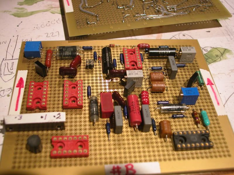

VCO (less the Dorritos):
(some good parts):
http://i5.photobucket.com/albums/y177/Midiot/DSCN1801.jpg
I tried three different fet's...MF102, 2n3819, 2n3823..all worked. That extra chip socket at the bottom is for a 49.9k DIP resistor (cv inputs).

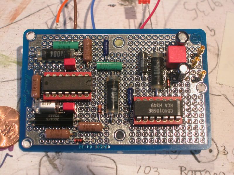

Signal to gate:
(back):
http://i5.photobucket.com/albums/y177/Midiot/dscn1806.jpg

VCO - waves look good on scope, but Pulsewidth control pot will not give me perfectly spaced square waves (longer bottoms w/shorter tops)....it approaches good spacing, but stops short. Does this matter?
When "tuning" for 1volt/1 octave, do I need to look up the standard frequencies and tune to them?....or should the frequencies just double per volt increase? (boy, that a basic Q, whew !) I have a circuit that puts out 1v - 5v, for tuning.
In other words, what should my frequency meter read as I increase by 1v steps?
Signal to Gate: - Works well. I'm using a CD40106 (same as 74C14 I believe). Puts out a 12v gate, is this too much? I assume it puts out whatever voltage it runs off of.

Yeah, the VCO tuning - just tune for doubling of frequency per volt.
The 12V gate IIRC is what to expect from Ray's signal to gate converter. In fact, the modules of his that I use, like the EG's, won't gate or trigger from 5V sources. I put in comparators on the inputs so they'd trigger on lower levels.
The pulse wave - not sure - by smaller at top, do you mean they tops are are starting to come together like a triangle wave?
No, The pulse width pot changes the space of every other vertical line in the squarewave (they remain upright).....the pot won't let me adjust them so they're equally spaced. I don't know if this a problem or not...yet. I may have to wait 'till every thing is hooked up together.
I like using those boards with a ground plane on one side,,,,,but I gotta be carefull.....one tiny flake of metal will create a short !! So, I test the plane every 3rd or 4th time I add some components, so I know where to look for a problem. The worst place to get a flake lodged is under a 'lytic, or an IC socket (an air blast usually works). I don't connect anything to the plane till I know everything is working first. In fact, I'll probably coat it (a conformal coating) just before mounting it into the case. I've been reading that some components should not have a ground plane beneath them, as they could inject "stray capacitance" to the plane......... Rolling Eyes ....I'm still a beginner.
