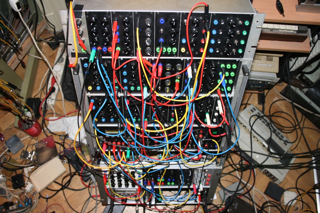

this thread resurfacing inspired me to go back and finish up the quad linear VCO i started a few months ago, based on the 8038.
the switches next to the freq. control are range switches, regular or LFO. 2 CV ins per osc.; CV2 for osc 1 & 2, and 3 & 4, are normaled to the tri outputs of each other, so you have easy access to 2 pairs of cross-modulated oscillators.
from the descriptions, this might be similar to the core circuits of the 2 Livewire modulators (dalek and vulcan), but I have no idea if they are in fact similar.
finished it up around 9 last night and fooled around with it for another couple hours... much fun.
