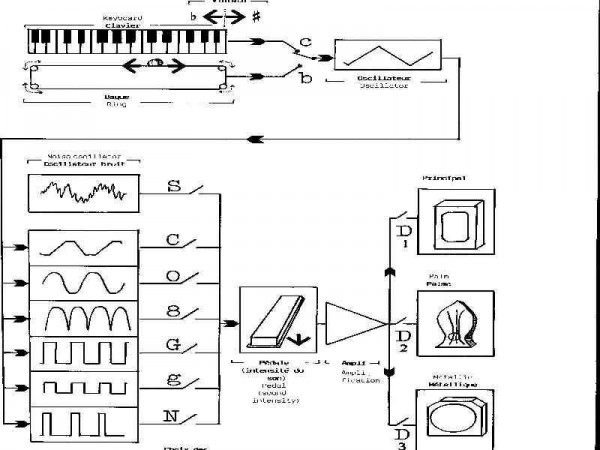

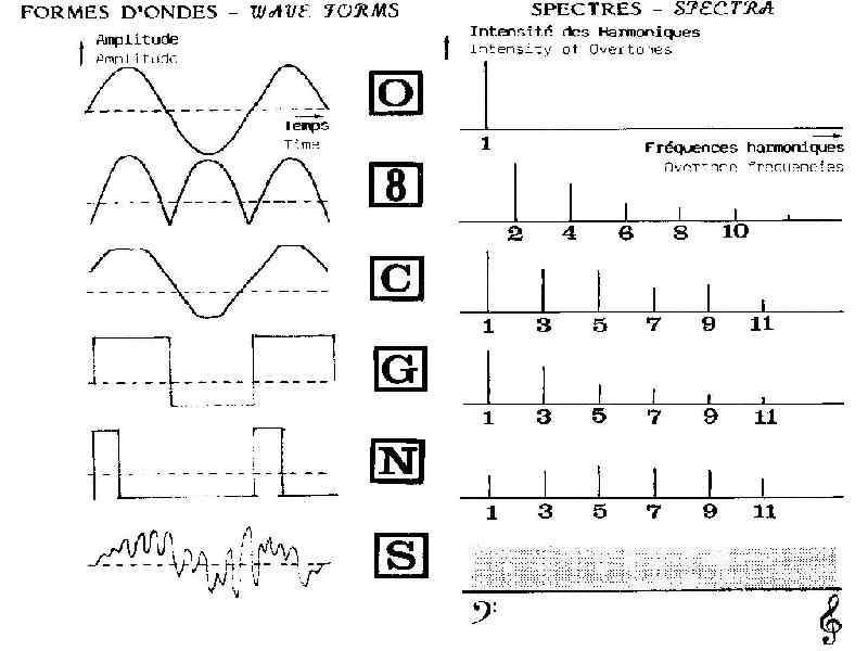

I found these from Yahoo Analogue Systems forum: A block diagram and some waveforms scanned from an Ondes Martenot study book written by Ms. Loriod. Digital versions of the presented waveforms don't sound particularly magical. Spectrum for waveform "N" seems wrong.
Best regards
