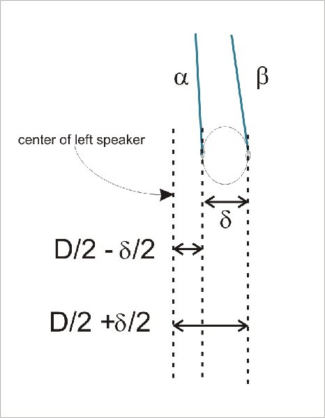

PostPosted: Sun Apr 13, 2008 3:40 pm    Post subject: Reply with quote  Mark this post and the followings unread
Kassen wrote:
What is, for example, the link between the space between the speakers, their angles and the delay length? What phenomena is this based on and why?
I could certainly be wrong but it seems obvious from first principles that:
 Filesize:  61.12 KB
 Viewed:  725 Time(s)
bachus
Joined: Feb 29, 2004
Posts: 2922
PostPosted: Sun Apr 13, 2008 3:44 pm    Post subject: Reply with quote  Mark this post and the followings unread
Using Howard's "rule of two thumbs" for speaker placement this yields ~53 microseconds delay at a listening distance of 9 feet with k set to 0, thus k is fairly small.
k is not a constant but a function of D and d. I should be clear from inspection of the image that k is less dependent on d if D is small. This is one of the advantages of Ambiosonics over Sonic Holography.
Clearly if you make D large you will need to use a HRTF (equalization) that is a function of D and d.
Again this is not an area of expertise for me, it's just what seems the obvious and necessary consequences of the conceptual description of ICC. I hope to learn from any critiques of this.

PostPosted: Sun Apr 13, 2008 6:35 pm    Post subject: Reply with quote  Mark this post and the followings unread
More accurate drawing detail:
Edit:
To be clear 'D' is the distance between the centers of radiation of the two speakers and the listener is placed on the perpendicular bisector of that line.
 Filesize:  45.28 KB
 Viewed:  723 Time(s)

PostPosted: Mon Apr 14, 2008 2:54 am    Post subject: Reply with quote  Mark this post and the followings unread
Ok. So now it's clear how the speakers are to be placed, exactly. What's not so clear to me yet is how this will remove cross-talk. Maybe we *could* but only if the listener would set very still at a very well defined spot.
Another note on "K", am I right in assuming that K doesn't take into account how the way in which "sound wraps around the head" is frequency dependant?

PostPosted: Mon Apr 14, 2008 5:52 am    Post subject: Reply with quote  Mark this post and the followings unread
Yes, I think it is made clear in all the literature that Abiophonics has a finite sweet line. Almost all other ICC systems have a sweet spot. I think I've read of a DARPA system that tracks the listener's position and dynamically adjusts the time delay and HRTF.
k only takes care of the *(head wrap) distance parameters .
The HRTF *(Head Related Transfer Function) takes care of that issue. If the speakers are close *(as they are in Ambiophonics) to each other an HRTF is not really an issue.
As to weather (or is that a neutered goat?) or not ICC works one only has to press the bypass button on such a system. The sound field immediately collapses and source positions become more vague. The loss of stage is absolutely dramatic. I would just do a search on Intraural Crosstalk Cancellation there are many papers on the subject.
As to how: the block diagram at the start of this thread should make that clear.
