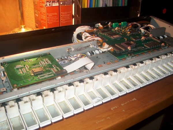

I have a Roland D-50 and it has one G key in the middle of the keyboard that makes no sound. I had the same problem with the lowest D but after spraying solvent cleaner between the keys I was able to get that one working again. I need to get at the rubber contact pad underneath this G key and clean it with some denatured alchohol. I've opened up the bottom and now have to remove the two computer cards to get to the keys. There's a small one on the left and the Roland D-50 Main board on the right(see photo). How do I remove these.....just like any computer board? Question

Are you sure you need to remove those boards ... to me it looks more like there is a contact PCB under the keys for which the keys have to be removed in order to reach it. Do the keys have springs to hold 'm at the back side ?

The whole metal part that you see there under the boards is the keyboard assembly. It's screwed to the chassis and there are no springs.
This is what I can tell so far. The board on the left....the small one...stays there but gets disconnected from the main board. It's actually attatched to the keyboard assembly. The main board is unscrewed and can be lifted up....but I'm not sure if all the cables to it are disconnected or not. AND, I don't know if I have to disattatch the cables that go to the power supply. Confused
Plus I've reached a new impasse......there are cables that reach up and over to the display that are bundled to the back of the keyboard assembly, preventing me from pulling it out(see photo) so I'm wondering if I have to completely remove the main board and then flip the keyboard assembly over while it stays attatched to work on the keys. Otherwise I'd have to cut the ties that bundle the cables.....which I don't want to do.

From memory I think we need to disconnect enough of the main board to move it out of the way. Then the entire keyboard assembly will come out from under it.
My problem isn't the removal of the board but the bundled cables that are strapped to the backside of the key assembly...preventing me from moving the key assembly out of the D-50(see the photo in the upper post).These cables are on the top right to the left of the Main board and one of them runs to the display buttons on the front....so you can't access the other end. This is the thing that perplexes me......is the keyboard assembly supposed to pull completely away from the main housing or just enough so it can be flipped over and worked on? Is it just this version of the D-50 that is like that? Confused
AFAIK the whole board has to come out, that's what the instructions I have tell me. Mainly because you want that delicate Main board out of the way to prevent any damage to it. Exclamation Must be very careful with it and use a grounding wrist strap when you go in to move it. Wink
I have a 4-page instruction in text form that a nice person from vintagesynth.com sent me last night. If you PM me I'll send them to you so we're working off the same page as it were. Wink
Unfortunately it makes no mention of the bundled cables in question. Rolling Eyes Take a look at these cables when you go in there and let me know what you think.

To sort those cable bundles out you'll need to cut 6 cable ties along the back. Not the far left one, it's actually part of a clip which will let go when you remove the screw that goes through it. Don't worry about cutting the other 6, I put a little black cross on the metalwork to remind me where to put one back, but they stay together fairly well anyway.
The rubber contacts under the keys need to go back the same way around, (this is the key to your velocity sense) Exclamation
I actually removed the clear plastic strips which he talks about pushing out of the way. They don't hold the keys in (the springs do that) and they don't help stop dust. I think they are part of the manufacturing process, ie; they hold the keys in place until the springs get put on. Not needed, and heaps easier without them in the way. I won't throw them away just yet though. Wink
I cleaned out heaps of dust and crap from mine. Don't forget to take the opportunity to clean the actual keys as well. It comes up looking new if you do.

Okay, here's the first pic. 20 screws, the back comes off and you can see the main board. On mine you can see the expansion board roughly in the middle with the orange backup battery holder. There are 15 connectors of different sizes which need to be removed. Putting them back in the right place is very easy.

this one is specially for Jan. It's a hi-res close up of the expansion board. The only connections to the main board are the original locations of the UV-EPROM pins. (On the board, pin 20 is hung out wider so it's connection changes.) And the red wire, which connects to a different chip on the main board.

Well, I've just checked under the main board again, and there are no cut traces. The red wire connects to pin 27 of a HM62256LP-12 which is under the expansion board. I checked both backup batteries, and they both have 3V+. I also put back another two cable ties. I closed it all up, plugged the headphones in and had a good little tinkle.
I must say that the action of the keys both feels and sounds cleaner and more responsive. Seeing as how I didn't actually have any dead keys, like Gothboy has, I'd say that makes it a very worthwhile bit of maintenance to do. All you need is a D50, a few tools, a steady hand, 3 hours and an ESD wrist-strap. Wink
