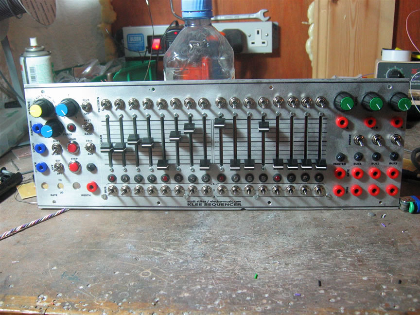

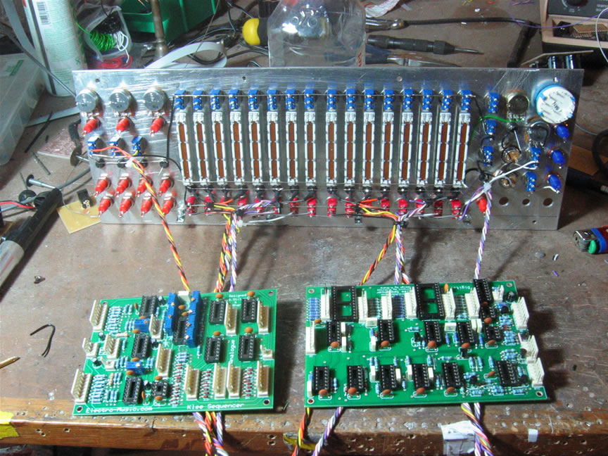

PostPosted: Thu Sep 06, 2007 2:47 am    Post subject: Reply with quote  Mark this post and the followings unread
Coming along nicely....!....
Front'o'klee with everything mounted except the extra clock circuit

Back-side---- First stages of the massive wiring job!

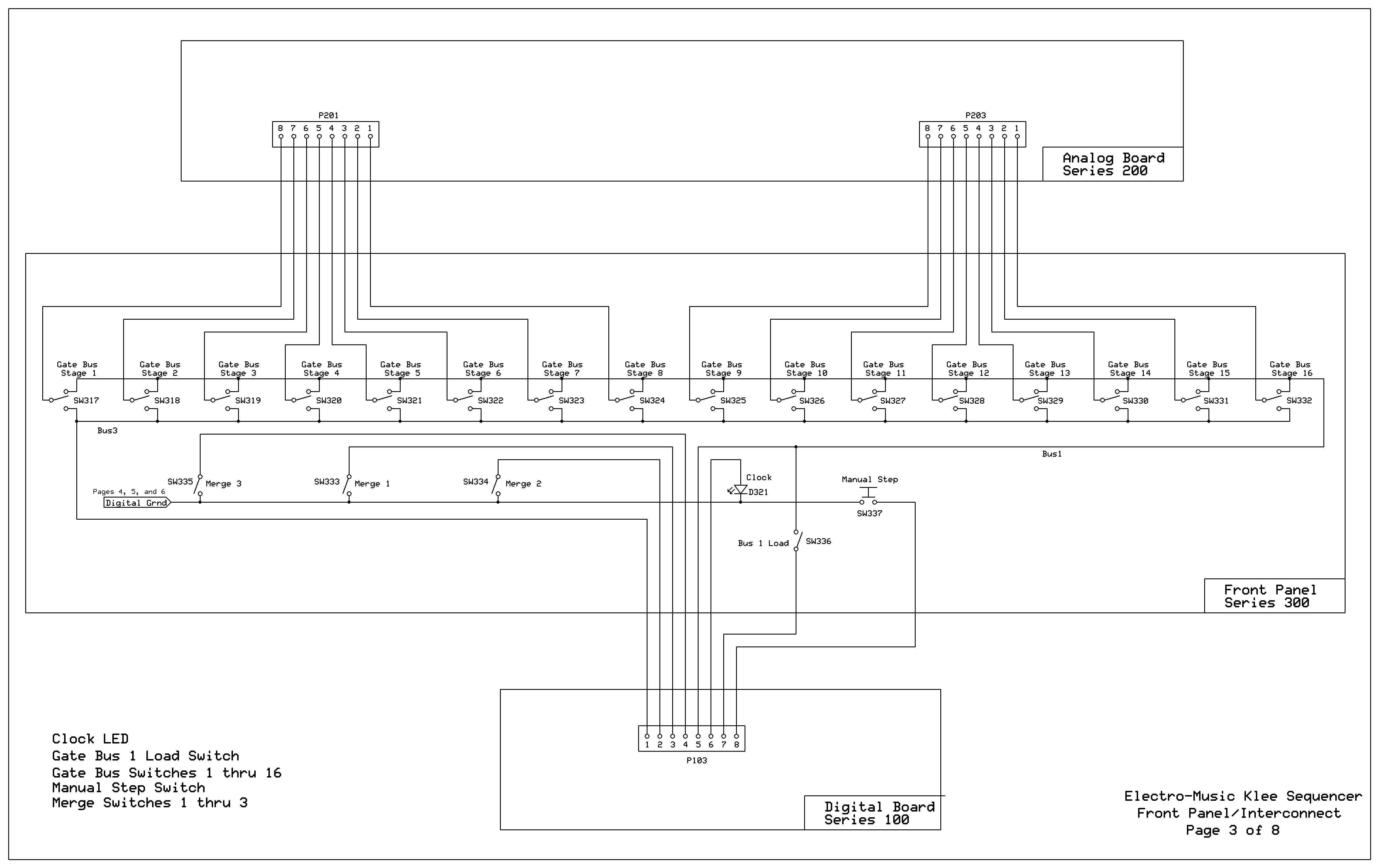

Hey Andrew,
Strap wiring is applying the wiring for all of the common connections the panel components have. For example, the pots each have to have a ground connection. If you consider that there are sixteen pots for the programming pots alone, that's sixteen ground connections right there. Instead of running a ground wire for each pot to the boards, you connect the ground points of each wire together and then run one wire to that common connector from the board.
Here's a page from the electro-music Klee Front Panel/Interconnect Schematic. If you take a look at it, you'll probably spot the "landmarks" on Bill and Tom's strap wiring pictures.
Note how the top and bottom of the gate bus switches all have a common connection (these are actually busses 1 and 3). The center of the switches each have their own individual connection - that makes up Gate Bus 2. Those connections each require an individual wire going back to the board. If you look at Bill and Tom's pics, you'll spot that row of switches with a length of bus wire connecting the top and bottom of the switches, but they haven't connected anything to the middle pin because they have yet to begin wiring the wires that connect to the board.
Also note that the merge switches, clock LED and the Manual Step Switch all have a common connection - they all connect to Digital Ground. So, that's another common connection you can wire into the panel. Wiring all of these common connections before wiring in the harness wires makes things a lot easier to assemble. Don't worry - the build doc will take you through the various steps.
The harnesses are not all as bad as it sounds. If you decide to use connectors, you can build the harnesses up ahead of time. This involves taking the wires, crimping or soldering pins onto them, and shoving those pins into a connector housing. The housing may hold two, three four, six wires or eight wires, and that's how many wires you shove into them. You end up with a housing with a number of wires hanging off the end. When it's time to put the Klee together, the loose ends of the wires solder to the panel parts, and the housing connects to the appropriate connector on the board.
Scott
