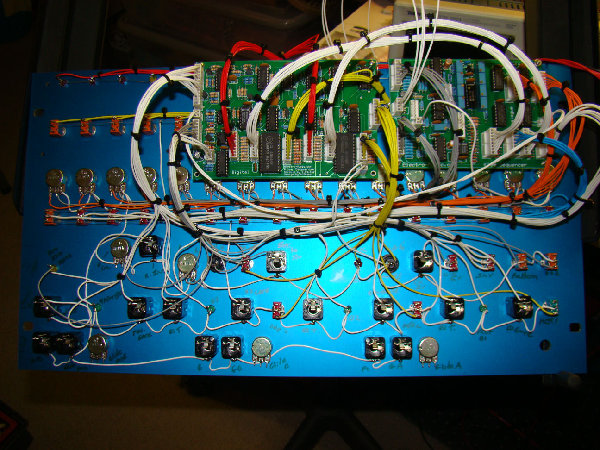

PostPosted: Fri Sep 14, 2007 8:04 pm    Post subject: Reply with quote  Mark this post and the followings unread
The "New York Based" prototype platform ......
Bill

shawn
Joined: Dec 13, 2005
Posts: 209
Location: savannah
PostPosted: Fri Sep 14, 2007 8:37 pm    Post subject: Reply with quote  Mark this post and the followings unread
Bill
Where did you get your pretty wire from? That is such a very nice and neat wiring job.
Posts: 2810
PostPosted: Sat Sep 15, 2007 5:21 am    Post subject: Reply with quote  Mark this post and the followings unread
Looking good! Great work!
Thanks Stein Very Happy Things are going fantastically well and I am happy that all the guys are excited. The Klee prototyping team is highly communicative and responsive. It's a winning combination. Scott and all of us have just about reached agreement on the final, minimal, changes to the EM-Klee circuit and printed circuit boards.
Bill
Posts: 2810
PostPosted: Sat Sep 15, 2007 5:27 am    Post subject: Reply with quote  Mark this post and the followings unread
I work at a company that builds radar and avionics gear. There is a large prototyping and electrical assembly shop in my building so I have access to many spools of wire ... Thankfully Very Happy
Believe it or not, my Robin does a far better job than I but thanks for the nice words Shocked She is a pro at soldering 240 pin and more, fine pitch, surface mount IC's. She is a printed circuit board rework specialist at Telephonics where I work. I am so proud of her.
It's a nice combination, I design, she builds. At home, I do all my building and PCB design to keep in practice .... Very Happy
Thanks,
Bill

frijitz
Joined: May 04, 2007
Posts: 1734
Location: NM USA
Audio files: 54
PostPosted: Sat Sep 15, 2007 9:40 am    Post subject: Reply with quote  Mark this post and the followings unread
Scott Stites wrote:
I bet that wire is the nice teflon insulated stuff, too, esp if your co does military work. Man, there's just nothing better on the face of this earth than that stuff, other than asparagus.[/quote
Scott
You''re serious Shocked Question
I'll send you a big boxful I collected from govt surplus. I hate it because it doesn't stay in place when you bend it and its toughness makes it hard to strip without nicking the wire.
I like the kind you can strip with your teeth. Very Happy
Oh, nice demo!
Scott Stites
Joined: Dec 23, 2005
Posts: 4127
Location: Mount Hope, KS USA
Audio files: 96
PostPosted: Sat Sep 15, 2007 9:46 am    Post subject: Reply with quote  Mark this post and the followings unread
Oh, yes, I do love the stuff. I was spoiled by it because I could get it in much the same manner as Bill. When I ran out, I switched to rat shack stuff and figured out in a hurry I can't accidentally get the soldering too close to the stuff before it likes to melt. Rolling Eyes
I've got some serious industrial grade strippers, and so far they've worked well with it.
Scott
