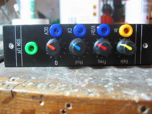

Hey I finally got mine built. Great great sounds. Compact power! And I've got another SSM2044 chip free for later use..
There were a couple of little mods I did which maybe have/have-not been mentioned before.
-- Inverting or non-inverting -- I chose to go for the inverting input due to the inverting buffer afterwards. Popped up a resistor and flew a wire across. I'm not sure what other people would think on this subject??
-- the other thing was the Freq pot -- I just noticed the comments above from Mathias - yeah, I found that I couldn't get a decent range originally (though I did wonder whether my 12v supply was the issue) so I cut the Freq pot's trace to ground and jumped in another 47k resistor down to v-. This definitely seems to have made things better.
Aceness! I want to do a souped up version for the 2nd SSM chip.
