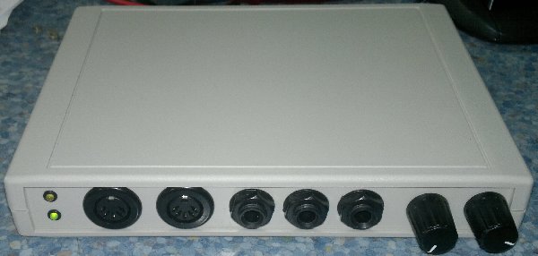

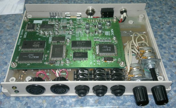

PostPosted: Mon May 09, 2011 6:00 am    Post subject: Yet another project Reply with quote  Mark this post and the followings unread
I'm reading this forum for about 4 months and it inspired me to build my own GM Voice project. Thank you guys, all of you.
After a long period of designing, and waiting for the board, and waiting for the DB60XG clone, and the MAX743, and a USB/MIDI cable (long live eBay and Chinese sellers), it took me only 3 days to assemble the whole thing. All other parts I bought in local stores, including the casing. I wanted it to be as much portable as possible, so I chose the slimmest possible casing that could fit the project, and voila! Very Happy
The PSU uses 7805 for the +5v rail (no surprise) and MAX743 as a dual output commuting power supply for +/-12v rails. And the whole thing is powered from an external and widely available 7.5v power adapter. I'm very pleased with this approach because it uses a single voltage supply and the 7805 does not get too hot. I also used a 1N4008 in series to protect against polarity inversion! Crying or Very sad
And it works so damn good! And because my M-Audio KeyStudio 49i has a headphone output, I designed the same for this project. For this I took the idea from here.
I only didn't mark the panels, yet.

PostPosted: Mon May 09, 2011 6:04 am    Post subject: Reply with quote  Mark this post and the followings unread
well thought build. great.
BTW where do you got the MIDI sockets? are they snap-in? i like them.
vlad2011
Joined: May 09, 2011
Posts: 6
Location: Bucharest, Romania
PostPosted: Mon May 09, 2011 8:41 am    Post subject: Reply with quote  Mark this post and the followings unread
The MIDI sockets are in fact 5 pin DIN sockets and, yes, they are snap-in type.
At the beginning I designed the board for PCB mount sockets, but I failed to find them locally. So I tried to find panel mount ones and I found those by chance in a store (in Bucharest...). I don't know any code or something.
I'll try to find some reference on the net.

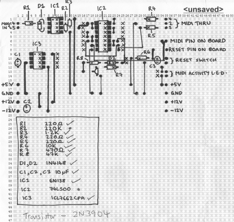

To start with, hello everybody - this is my first post.
I've been following this project for quite a while now, but only recently have I decided to actually build it. I followed Thomas Henry's schematics and build the circuit on strip-board. However, I've got quite a problem. I connected the circuit to one of the NEC clone boards and was very impressed with the sound. This worked for about half a hour, but on resetting the unit, the board would no longer respond to anything. Assuming that the board was faulty, I ordered a second one only for the same thing to happen again.
For the power supply, I'm using an external Molex power brick which supplies +12v and +5v. I'm using a ICL7662CPA to convert +12 to -12V. My multimeter reports voltages of +5.17v, +12.33v and -11.71v.
If anybody has any ideas, they would be greatly appreciated because I really am at the end of my tether.

PostPosted: Tue May 31, 2011 1:49 pm    Post subject: Reply with quote  Mark this post and the followings unread
Are these voltages with the NEC clone connected? The +/- 12V supply if I remember correctly supply the audio circuits on board and there are two onboard regulators so you can use +/-9V instead of 12V. These boards get quite hot and need good air circulation so did any of the onboard chips get hot? I have 3 clones and 2 originals and all have functioned perfectly on either DC to DC +/- 12V convertors or using a separate transformer for the 12V. Have you got a reset button or are you using a Capacitor?

PostPosted: Wed Jun 01, 2011 12:16 am    Post subject: Reply with quote  Mark this post and the followings unread
Thank's for the reply.
These voltages were taken with the board connected and powered up. The boards certainly did get hot. For the reset, I'm using the switch and capacitor as suggested in the original schematic.
Harry

PostPosted: Wed Jun 01, 2011 9:32 am    Post subject: Reply with quote  Mark this post and the followings unread
Harry
How are you controlling the board keyboard or computer? I remember I did have a problem once when an NEC would not start and I sent it a sysex XG reset message and it worked. With my PIC controller I always send this on startup.
If you have XG Gold there is a button to do this as well or type it into MIDI-OX sysex panel.

PostPosted: Thu Jun 02, 2011 8:30 am    Post subject: Reply with quote  Mark this post and the followings unread
Well, the actual circuit on veroboard is a bit chaotic, plus it's all attached to connectors and switches. However, I can confirm that it is faithful to the following plan :

PostPosted: Wed Jun 08, 2011 7:13 am    Post subject: Reply with quote  Mark this post and the followings unread
Harry
That looks OK. I would be tempted to use a different power supply if you are getting a new board. Or even try batteries monitor the tempreature +++. Might be worth checking the current the "dud" boards are taking if any.
