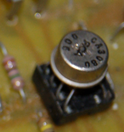

PostPosted: Mon Jan 21, 2008 10:37 am    Post subject: Reply with quote  Mark this post and the followings unread
Cans are more expensive and rare and, IIRC, are not difficult to fit into a DIP8 frame

etaoin
Joined: Jun 30, 2005
Posts: 761
Location: Utrecht, NL
PostPosted: Tue Jan 22, 2008 8:40 am    Post subject: Reply with quote  Mark this post and the followings unread
As this one in a Transcendent:
3080 can in a DIP8 socket
 Filesize:  50.98 KB
 Viewed:  13920 Time(s)
http://www.casia.org/modular/
