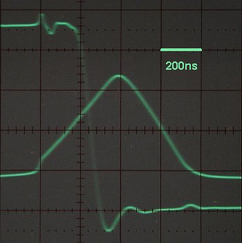

Well, the way I look at it, the Idss is (roughly) a measure of the maximum discharge current. It doesn't do you much good to have a small Rds resistance if the current is limited by another mechanism.
As far as the 2SK30, well now we are in MOSFET territory -- a whole nother topic. Since it is a depletion-mode device, you can indeed just pop it into Terry's design. But if you look at the data sheet you will see that again it is intended as a small-signal RF device. But I wouldn't argue with Takeda San, and if it works for you, then great!
I have a design for a super fast core that uses an enhancement mode MOSFET (VN0104 or BS170), which allows the LM311 comparator to be powered from ground, which improves the switching time. I developed a special pulse shaping circuit to discharge the cap in 200 ns with minimal ringing. I had this up on my website temporarily a couple of years ago. It's a screamer! I see now that I used a 2SC1583 pair for the converter, and according to my notes I got perfect tracking up to 40 kHz.
Here's a picture of the reset part of the waveform. The triangle is the switching pulse applied to the MOSFET and the other trace is the Saw .
You won't probably hear much difference with a fast reset, it just makes tracking more accurate.
Ian
