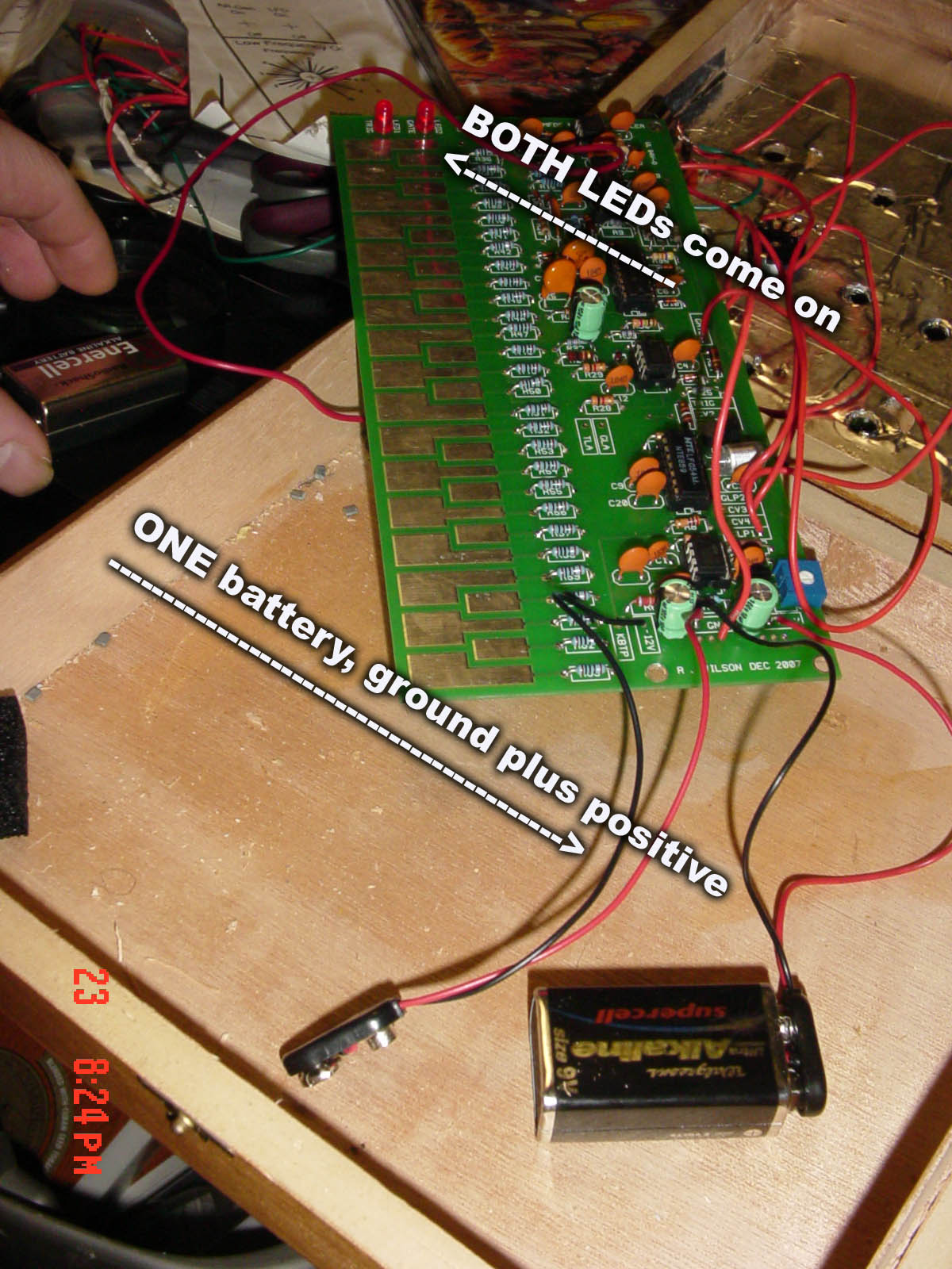

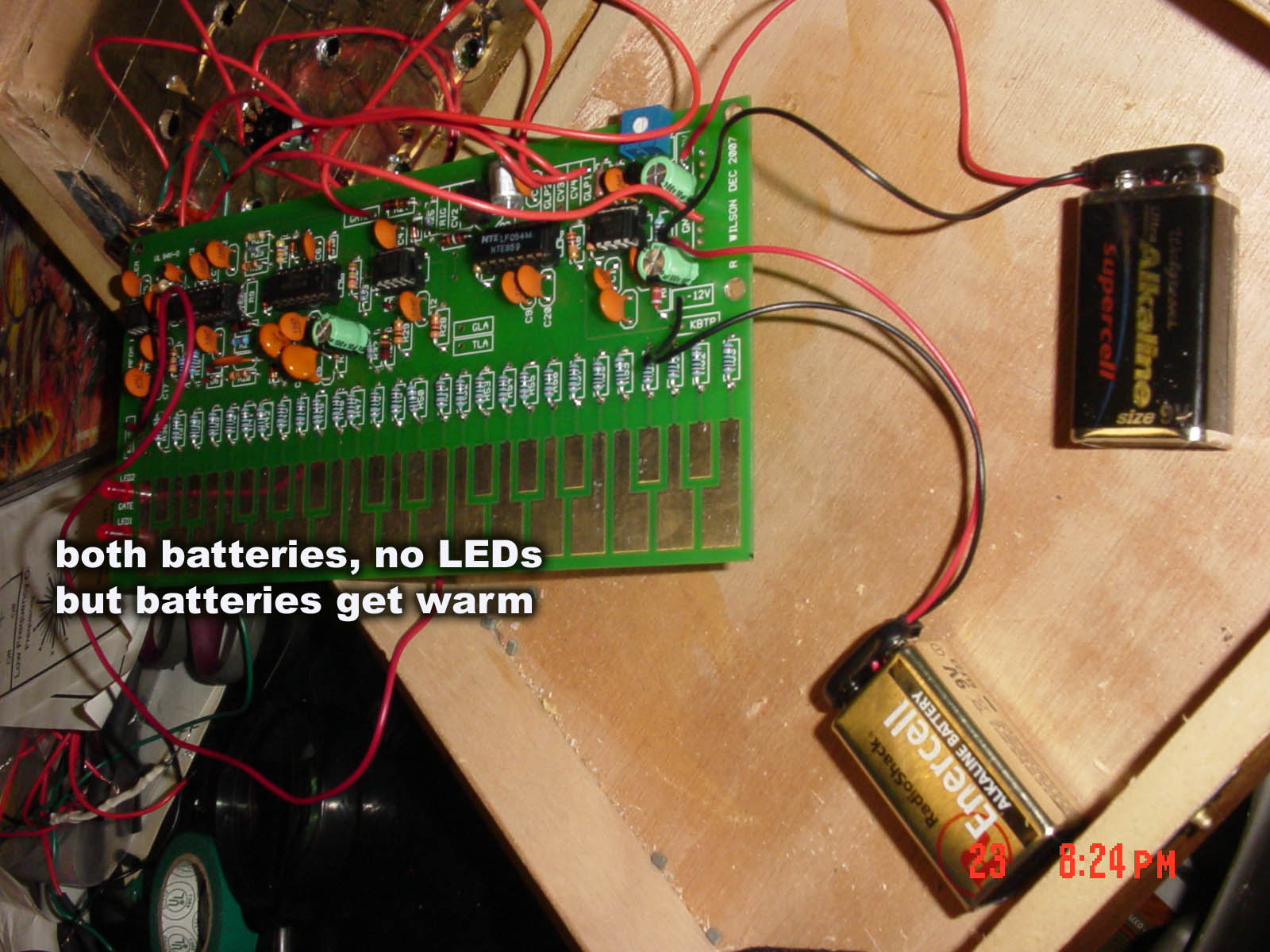

PostPosted: Tue Nov 18, 2008 4:38 pm    Post subject: Reply with quote  Mark this post and the followings unread
Got it built....but can't get it to work.
The batteries get really hot.
And I have double-checked all of the wiring and so far I can't locate any shorts or miss-wirings. (I DID find a short in the ground wires between the jacks (CV and Gate) and fixed that....the batteries get less hot, but still hot)
When I have ONE battery installed both of the LEDs come on and stay on (I don't think they are supposed to do that?) but if I put BOTH batteries in, then the LEDs do NOT come on. If I put ONE battery in the other clip, the LEDs do NOT come on.
And throughout all of that, the thing doesn't work.
On the power-input side, I used 2 caps that are rated at 100v rather then....uh, whatever. I think they are 10uf. But the voltage rating shouldn't matter, right? Thats just the max amount of voltage those can take before they blow up, right?
I get no LED reaction when touching the 'wand'(BUS) to the resistor chain.
And the gate/CV inputs on the soundlab show no reaction to anything the mini-controller (doesnt) do.
What else should I check and do?

PostPosted: Tue Nov 18, 2008 7:31 pm    Post subject: Reply with quote  Mark this post and the followings unread
If the batteries get hot, I'd be looking for a short, or check your battery harness polarity..
The caps should be fine - be sure you have the polarity correct on those...

PostPosted: Mon Nov 24, 2008 1:39 pm    Post subject: Reply with quote  Mark this post and the followings unread
good luck ;0
bruce
I've gone through everything, checked the diodes and caps for polarity, and can't find anything reversed or out of line.
It seems like I ordered some resistors from Mouser that are a bit weird or different then normal resistors.
Does it matter if resistors are carbon composit, or metal film? Or even made from big foot hair?
And are "Ceramic Disk SUPPRESSION" caps a different beast then a regular ceramic disk cap?
The immediate issue seems to be power.
With ONE battery in (On one certain side of the bi-polar 'harness') the LED lights come on, and stay one, regardless of if the wand/bus is closed against a key pad/key. With ONE battery on the other side of the harness, there is nothing. With BOTH batteries attached, there is nothing, but the batteries get hot.
What should be my next step as far as trouble-shooting?

PostPosted: Mon Nov 24, 2008 4:52 pm    Post subject: Reply with quote  Mark this post and the followings unread
So your batteries are connected like this.... right?
http://www.musicfromouterspace.com/analogsynth/ninevoltsupply.html

PostPosted: Mon Nov 24, 2008 7:57 pm    Post subject: Reply with quote  Mark this post and the followings unread
YES.
Here are some pics of my PCB.
As you can see, both batteries are connected properly (Unless you can see something I'm not seeing? Thats possible...I can stare at things and miss the obvious)
ALSO, the page for this controller show the jacks (CV and GATE) go to "Ground", so I am assuming that this is the ground that it refers to? (The one that the two wires/ground from the batteries go to?)

 Filesize:  291.27 KB
 Viewed:  229 Time(s)
 Filesize:  258.64 KB
 Viewed:  234 Time(s)
 Filesize:  280.94 KB
 Viewed:  232 Time(s)

OK - just wanted to be sure Smile
I can't think of any reason they would warm up except for a dead short....or nearly so...
Pull the batteries, use your VOM and measure resistance from ground to +,
then from Ground to -,
then and from + to -.
Anything stand out??
Then maybe pull the IC's and do the same measurement... (sockets right?)
There's a place to start anyway...
www.sdiy.org/rfeng
Chrometuna
Joined: Aug 14, 2006
Posts: 209
Location: Topeka
PostPosted: Mon Nov 24, 2008 9:48 pm    Post subject: Reply with quote  Mark this post and the followings unread
OK, I did some checking and poking with my multimeter, and I can't see anything out of line.
I show no resistance (Meaning completely open, as in not shorted) between all of the power points +/-/G
Is that what I SHOULD have?
Should I be seeing some kind of continuity, with resistance between those battery connections?
I repeated that without the chips in, and got the same results.
I DID however, spot a resistor (475 O at R5) that I used an odd-ball looking resistor....I don't know why I ordered it from Mouser? But I have another 475 resistor (1%) that I can swap into there and see what happens....but the existing one measures at 475 ohms, so I think it is doing what it is supposed to do.
Using my multimeter on the existing resistor
RF
Joined: Mar 23, 2007
Posts: 1502
Audio files: 28
PostPosted: Mon Nov 24, 2008 10:38 pm    Post subject: Reply with quote  Mark this post and the followings unread
Hang in there Chrometuna - you'll find this.
Ray notes on his pages that it draws 30 ma current at 12 volts....so Ohms law says you should be seeing 400 ohms resistance between the Power supply + or - and ground.... (R=voltage/current)
Check your measurements..... or your meter range selector...
