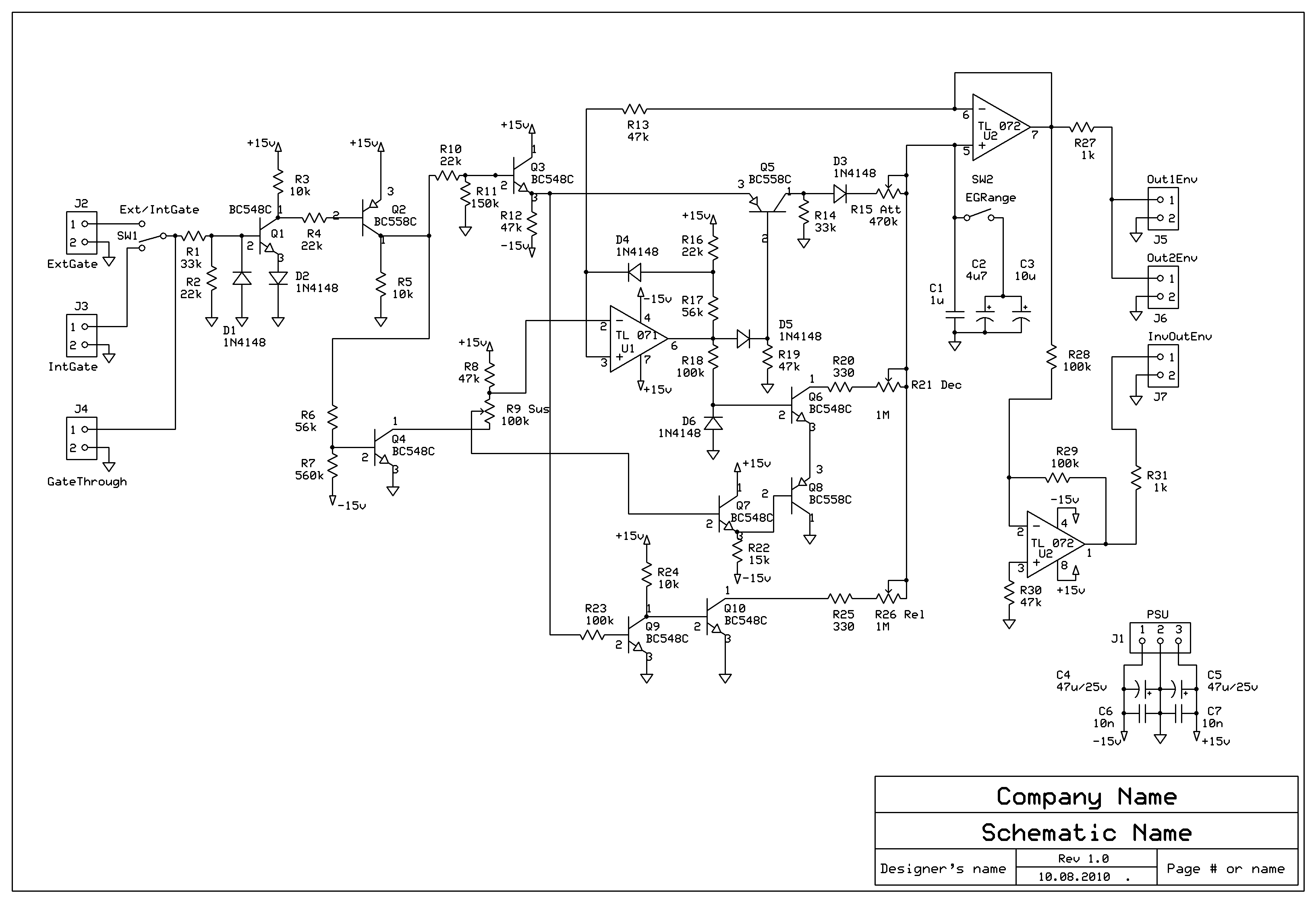

Check the adapted schematic. It allows to use more normal pot values. And it has two ranges with the small one quite more faster than original Roland ADSR. I could be not very difficult to make this small changes to your perf layout if you want.

And you do not realy need tantalum for timing capacitor, since they are not so cheap, but if one goes for small range capacitor of 1uF, I would advise using polypropylene for uniform performance at shortest settings like used for bass or percussive sounns. Power supply rails decoupling is good idea too. For attack pot you can use 500KOhm if there is no 470KOhm arround. All pots can be linear.

Ok thanks, probably no need to change the layout, as the timing caps can be mounted directly onto the range switch.

Sure:) Polypropylene could be a litle bit big

Hi Frequency Central:
I was thinking about the change of C1 value...
Minimum attack is 1.5 ms and minimum decay and release are 4ms with the original capacitor and pots.
Pots don't affect the minimum times because are set to 0 resistance, so I think that a bigger value of C1 will increase the minimum attack, decay and release time.
And one thing I try to achieve is a fast attack time.
Do you measured the minimum times with C1=4.7uF?
I think that minimum attack time will be increased to about 2.5ms.

I haven't measured it. Probably implementing a switch for the capacitor like 1234 suggests would be a really good idea.

It seems to me that the current flowing into the envelope capacitor during the attack cycle is limited by R17. If we assume 13V from base of Q5 to ground then Q5 base current is 276uA. With a transistor of hfe=300 the collector current will be 8.3mA. This will vary depending of the hfe of the transistor used, and the attack time may be able to be shortened by reducing R17. Keep in mind the ratings of the transistor used.
If I've got this totally wrong, someone please correct me!

Thanks Stewart, I will experiment with R17 when have some time to build this envelope.

One more thing: In the orginal schematic the pots are specified as type D taper (kind of super log), an Frequency Central specified them as type B taper (linear). I think that type A taper (log) will be closer to the original spec.

OK, sorry. A little green here. Here's what I understood:
The pots for A, D and R are set up as variable resistors and have thus no effect on the minimum times. Substituting those for 100K pots will merely reduce the maximum times to a fifth/tenth of frequencycentral's layout. In order to compensate for these lower resistor values, the value of C1 could be increased to get longer maximum times. But this would also result in a slower minimum times, right?
How long are the maximum times of these envelopes anyway? Let's say the goal would be to have snappy envelopes that don't go super-long.

Yes, you get it right Smile
From the schematic (with original pots & cap values):
Attack: 1.5ms - 7.5s
Decay: 4ms - 15s
Sustain: 0 +10V
Release: 4ms - 15s
Sebo

Just completed my (first) 140 panel. The second ADSR I built has been sitting on my bench for a few weeks, waiting for me to realise that a 470k resistor is not a good sub for a 47k resistor. doh
I broke out the timing caps to a switch, at the moment I'm using 1uF for fast and 4.7uF for slow, but I think I'm gonna change out the 4.7uF for 10uF for mega-long envelope times.
