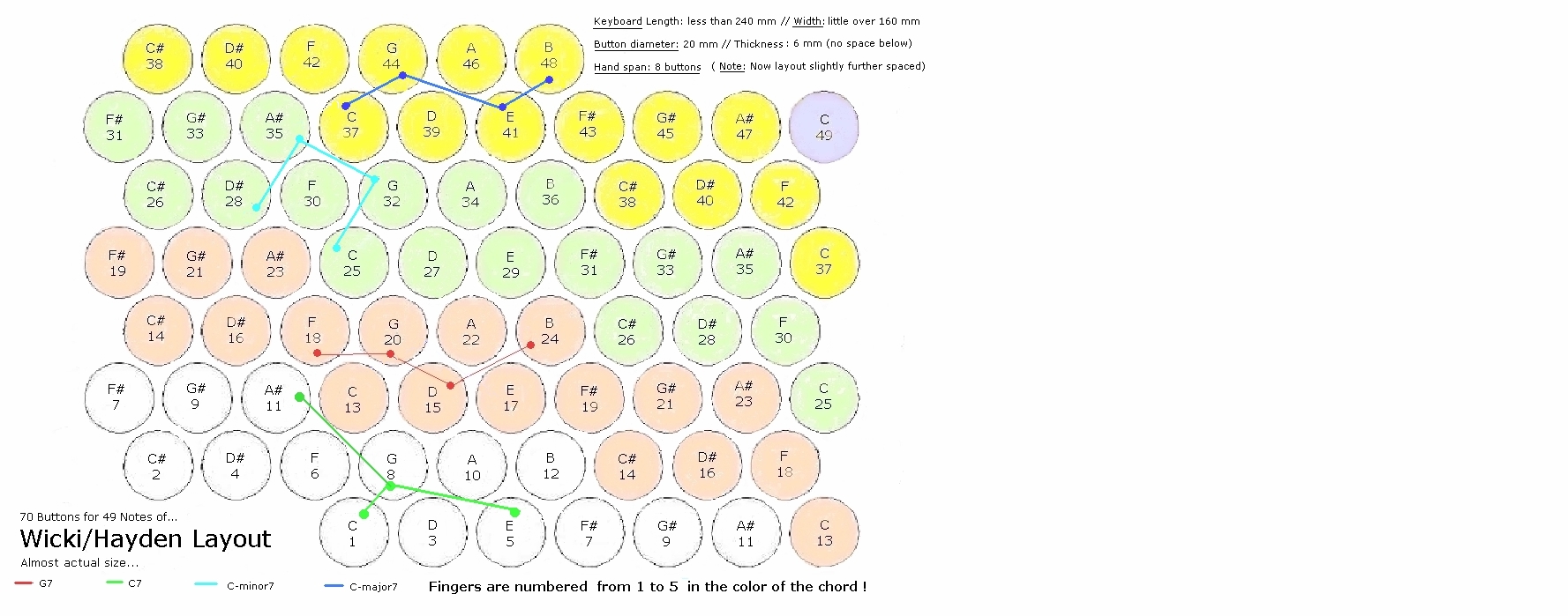

In my mission of "finding the easiest to learn & play keyboard layout," I only considered the Wicki, the C-System (easier than Bayan) and Janko to replace the awkward zebra piano layout.
Yesterday I tried to place a few chord patterns onto the Wicki layout and was shocked to discover how difficult the fingering of four note chords were! Now I understand what you meant... Ken with: "The Hard Part is learning how to learn how to play the thing". Sad
Albeit the Jammer keyboard has a decently sized buttons, it still will be pretty hard enough to learn its fingering patterns of 4 note chords and its inversions. Single note play will be much easier.
In fact the W/H fingering is even more complicated than the C/B-system accordion fingering! That's worrying...
In this regard even the lousy zebra piano is ergonomically better off.
These facts force me to reconsider the Janko, for it has both worlds: the advantage of layout uniformity and ergonomic comfort.
Its disadvantage is its hand span of only 1 1/2 octave, but then again, the zebra piano has even less hand span and sounds O.K., too.
In other words, the Japs must have done their homework with their Chromatone. Sad
It's about time I'm getting the fact right:
W/H:
1) Pretty hard to learn fingering patterns of 4 note chords.
2) I have to learn from the whole system from "0"
3) Easy to implement Klavarskribo type notation
4) 4 to 5 octave hand span!
C-System:
1) Button fingering easier than W/H
3) Very difficult to implement Klavarskribo type notation
4) Nearly 2 octave hand span!
5) Harder to learn than W/H (more irregular)
Janko:
1) Key fingering ergonomically ideal
2) Faster to learn, for I already play the piano accordion
3) Ideal to implement Klavarskribo type notation
4) Main disadvantage: hand span of only 1 1/2 octave!
5) Easy to adapt to any Synth (no electronics involved)
It would be nice if you great experts could scrutinize, enrich or amend my gathered facts. Thx
Note: Below the Wicki/Hayden layout is the C-system layout.
[url="http://imageshack.us"]Posted Image, might have been reduced in size. Click Image to view fullscreen.[/url]

...I tried to place a few chord patterns onto the Wicki layout and was shocked to discover how difficult the fingering of four note chords were! Now I understand what you meant... Ken with: "The Hard Part is learning how to learn how to play the thing".
Don't panic on the W/H layout. Did you not look at my Jammer chords posting?
In it you'll see that nearly all the common chords can be played with 2 fingers except the (dominant) 7 chords and the rare minor-major 7th. I've found (and checked with my wife) that for the 7th chords you can drop the 5th (she calls it optional) to simplify it, or you can be creative and press a 4-5 chord (with one finger) instead. Also, you can change the inversion to suit your fingers.
I expect your fingers will quickly learn (in a few months) the new combinations - the nervous system excels that that kind of thing. My major problem is learning to play the notes quickly and at the right time in both hands, a skill you have mastered. This will take me much longer, as I have to grow the faster brain wiring and this will take my tired old brain 12-18 months (see Scientific American article on the brain 3 months ago).
However, I found playing chords with fewr fingers is not everything. Often "rolling bass" chords (the notes of the chord played in sequence) sound more interesting. To play a rolling chord sometimes requires more fingers, usually 3 sometimes 4, and I found the fingers can be in an awkward position, but what the heck, that's true of any instrument.
If you go to the Janko layout, you will initially learn faster (it's close to what you already know) but your playing speed will be the same as a piano and cannot not hit the 3x faster than piano speed expected with W/H. It's your call.
Ken.

Yes, I really panic, Sad because this sad fact almost throws all my Wicki aspirations out of the window!
In it you'll see that nearly all the common chords can be played with 2 fingers...
The triads are no problem, but most four note chords are finger tanglers! Janko hasn't got that ergonomic problem. Often only one correct fingering applies. Sure, one can drop a note, but then it sounds poorer. In all my C-major and A-minor melodies I love to apply four note G7 and the minor septime chords.
Since age 16, I used to play my piano accordion quite regularly for over 12 years; inspired by the organist Klaus Wunderlich. I actually never packed it up; so it I played it almost every day for several hours, by ear. I even ran the cassette recorder slower to easier learn fast passages of great the accordion player Pino Piacentino. In the end I was that good that several people commended my self-motivated achievements.
Yet, I always found it absurd to learn and keep practicing other scales. I wished I would have heard of Janko or Wicki at that time! It would have been easy for me to adapt the piano accordion to Janko and I could have been a great accordionist by now. Instead, I developed my whistling to music. You see, the great thing about the pentatonic accordion bass accompaniment is that one gets a feel for it and then (like a singer or whistler) play it without even realizing in which scale it is. The right hand Thummer, Jammer or Janko layout ideally complements such setup. Also the 120-button accordion bass are far easier to learn and to apply.
I still have a latent musical secret left... that of composing interesting melodies. Once I put it to the test and almost couldn't stop it. So, I leave it dormant until I run out of puff; i.e. cannot whistle anymore. Yes, musicality is and always has been, a rather serious part of my life.
Since the Thummer and Jammer is aimed at hobby musicians, the left hand accompaniment could be automated by those interesting Yamaha Styles... driven via "1 finger" Live-Styler http://www.live-styler.de That would be a great help. I know the owner of Live-Styler personally, for I translated his website and manuals from Ger to Eng.
True, for all speed playing contests have been won by button keyboard players. It's, because button layouts are compact. In that Wicki excels! Yet then again, on the Synth one can play fast melodies quite well. I reckon most hobby musician will be quite satisfied with that speed; since top pianists are (!)

PostPosted: Fri Apr 25, 2008 6:33 pm    Post subject: Reply with quote  Mark this post and the followings unread
I had another look at http://www.box.net/public/g6v2ubkvp3 for chords. Also, I made the Wicki pattern bigger and so, I can finger it more accurately on my PC screen.
Some 4-note chords patterns are truly hard to finger. The Thummer operates with 4 fingers only. How to do that? Pretty twiddly, isn't it?
Yet, if the 4th not is chosen an octave higher or lower, the pattern becomes easier to finger and it sounds more interesting, too. This advice gave me Rich Morse; the W/H expert.
So, I suppose I'm going to go for both, the Janko and Wicki. As mentioned, all my electronic stuff is packed up (until I sell house, move and fit my workshop) and so, the only thing I can do this time is to unpack the Synth again (with the Janko keyboard on it) and practice this one and as soon I'm able to get to my electronic stuff, I'll build this Wicki button keyboard. At least I have got the necessary passion and time for it. Ideal job for resilient age pensioners, like me! Smile
Below is an enlarged Wicki pattern. Click on it twice to enlarge! I think the first click is the Thummers original button size?? Q: How big in diameter (mm) are the Thummer's buttons? Same as PC keys? Can you please reduce/ adjust the layout shown below to fit the original Thummer button size. That helps me to find the best fingering for each chord pattern. They (and their inversions) then have to be learned and practiced.
A good idea would be to create a flashcard chord learning program. This would help preparing for the theoretical part of playing the Thummer.
Actually, I plan to make up a W/H button chart and a chord chart, showing vital chord patterns so, that I can look at it during play.
Also, I'm going to create a few simple melodies on my innovative notation. That helps me to get over the initial hurdles. Smile

MusicScienceGuy
Joined: Jun 22, 2007
Posts: 97
Location: Vancouver, Canada
PostPosted: Mon Apr 28, 2008 11:03 am    Post subject: Reply with quote  Mark this post and the followings unread
Remember that you can use your thumb.
I've not used my thumb, because:
1. I plan to mount the two modulaion wheels on my thumbs, for cool effects - e.g. plucking strings, pitch bending
2. First things first; one should learn solidly the basics before going on to the extras.
ken.
Ps. make sure your button switches are light and responsive. my keys are about 2-3 times harder to press than a piano, and this prevents playing 8th and 16 notes.
