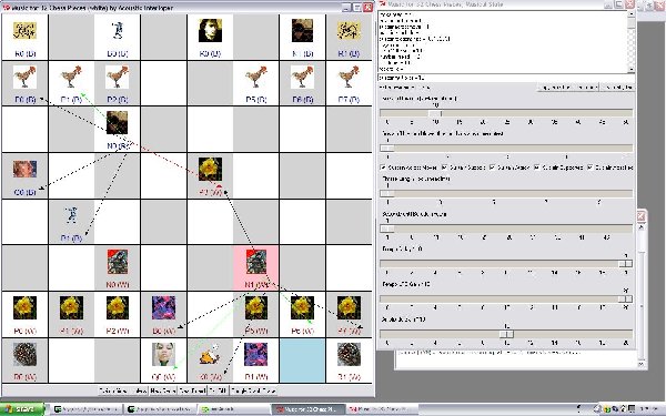

Here's a supercollider update to handle all types of releases correctly. The release condition is frequency <= 0 OR both amplitudes exactly 0.
When I get a chance (not tonight) I might design some more interesting sounds. Having an encoding for the type of piece would be very cool.

EDIT: The OSC protocol described in this post is out of date. Please consult the PROTOCOL_2.txt file in the latest chess/ source code posting for accurate protocol info.
I am not getting any sound out of SC. Previously I got sound out of the test case, but even that is not working. At least I know how to set my audio output interface correctly, and that was working before.
EDIT: I am using port 57120 for UDP, not working.
I tried following the instructions to highlight everything between the parens and "run" (selected from the menu), but I don't hear anything. Any suggestions? Thanks.
I will debug bank == 2 this weekend, and also hope to make the following enhancements to the UDP datagram format. I had considered using some of the unused bits in the current fields, but since this changes the protocol, anyway, I figured I might as well just add some fields and not force the sound designer to do extra work. I want to make this so one could conceivably generate music from another board game -- my wife and I play a lot of Scrabble -- so here is what I am thinking about the UDP protocol.
I am looking for feedback before I implement this from anyone who would like to express it. Thanks in advance! Please note that use of the new fields by the sound generation program is optional, although they must be parsed from the OSC/UDP datagram.
THE PROTOCOL:
1. bank(int) As currently defined, a bank of sound generators. Currently only 0 and 1 are used for the chess game.
The proposed protocol will allow optional additional banks. Also, any even numbered bank (l.s.bit == 0) signifies a support relationship in the game, an odd bank (l.s.bit == 1) signifies a conflict relationship. A bank number can exceed a sound generator's available banks, in which case the sound generator can either A) map the bank into one of its own banks (e.g., by setting realbank = bank MODULO numberOfBanksInSoundGenerator, or some other mapping), or the sound generator can B) silently discard the message.
2. oscindex(int) As currently defined, an offset into bank of sound generators. Currently 0 through 31 are used for the chess game. This value can be higher than the number supported by the sound generator, in which case it can either A) map it to a valid oscindex using modulo or similar, or B) discard. See similar comments for the bank number.
3. frequency(float) in Hz or -1.0 to signify "ramp down the oscillator to 0 amplitude without changing the frequency." The -1.0 value is deprecated at this point, since it is redundant with a pair of amplitude fields equal to 0.0.
4. phase(float) between 0.0 and 1.0 inclusive, or -1.0 (deprecated) similar to frequency. -1.0 occurs for both fields only on zero total amplitude.
5. left amplitude(float) between 0.0 and 1.0 inclusive. A pair of left/right amplitudes of 0.0 signify ramping the oscillator down to 0.0 amplitude and then freeing its resources if appropriate. A given oscillator in a bank may be reused repeatedly, with or without being zeroed in between. In general changes in amplitude should be ramped in order to avoid glitchy noise -- there may be a lot of rapid changes and oscillator use/zeroing/reuse from a game -- but this is up to the sound module designer. Maybe they want noise.
6. right amplitude(float) between 0.0 and 1.0 inclusive. Comments for left amplitude also apply here.
7. piece type(integer, use optional) from 0 through top piece in the game, whose relationship is being played. For the chess game these values are:
0 - pawn
1 - knight
2 - bishop
3 - rook
4 - queen
5 - king
These values could go higher for other games, so a sound generator must map "illegal" values into its valid range, or discard such sounds, as for other extensible fields defined in the protocol. Values in general should ascend, based on the value of a piece, move, or board configuration in a game. A sound generator can also ignore this optional field and generate sounds based on other fields in the message.
For example, generating sounds from a Scrabble(tm) game might pass the index of the highest letter, 'A' through 'Z' as 0 through 25, of a player's move. Alternatively, it might map the score value of a move into a range of buckets 0 .. N-1 giving a mapping of the overall value of the move.
8. player(integer, use optional) 0 through highest player-1 inclusive, in chess 0 for white and 1 for black. These values could go higher for other games, so a sound generator must map "illegal" values into its valid range, or discard such sounds, as for other extensible fields defined in the protocol. A sound generator can also ignore this optional field and generate sounds based on other fields in the message.
9. relationship(integer, use optional) of this tone. The chess program, and likely other future game programs, generate tones based on relationships of a piece being moved. For chess these relationships are:
0 - I support another piece
1 - I attack another piece
2 - I am supported by another piece
3 - I am attacked by another piece.
Odd values (l.s.bit == 1) always signify a conflict relationship, similar to the bank number. Even values signify support. These values could go higher for other games, so a sound generator must map "illegal" values into its valid range, or discard such sounds, as for other extensible fields defined in the protocol. A sound generator can also ignore this optional field and generate sounds based on other fields in the message.
Note that the Python chess program internally uses the piece type, player and relationship values in generating the preceding fields bank .. right amplitude, which is one reason why use of these fields is optional and they were not in the original protocol. The fields are present in the UDP datagram and must be extracted, but their use in the sound generator is not required. Where used, the even versus odd mapping for support versus conflict of the bank number and relationship fields can be used to select pleasant versus harsh timbre or effects. Mapping of the optional fields is always at the discretion of the sound module designer.
END OF PROTOCOL PROPOSAL

Select everything between ~chessAudio = ... and ~run.() and then press ctrl-return (in Psycollider - using SuperCollider.app on mac it's the keypad enter key). You should see "nil" appear in the post window followed by scsynth initialization text (if the server is not already booted) and the server window should show 9 UGens, 1 Synth and 3 Groups. (Number of synthdefs may vary depending on extension libraries.)
I don't have python set up on my work machine, but the test code - SC sending OSC to itself - does produce sound.
The "run" menu option is basically unused - it calls into Main's run method. It's misleading (I think it's a stupid name in the menu), but it isn't a synonym for "run the selected code." You have to use ctrl-return for that.
It works like a charm with the chess program, and sounds great!
