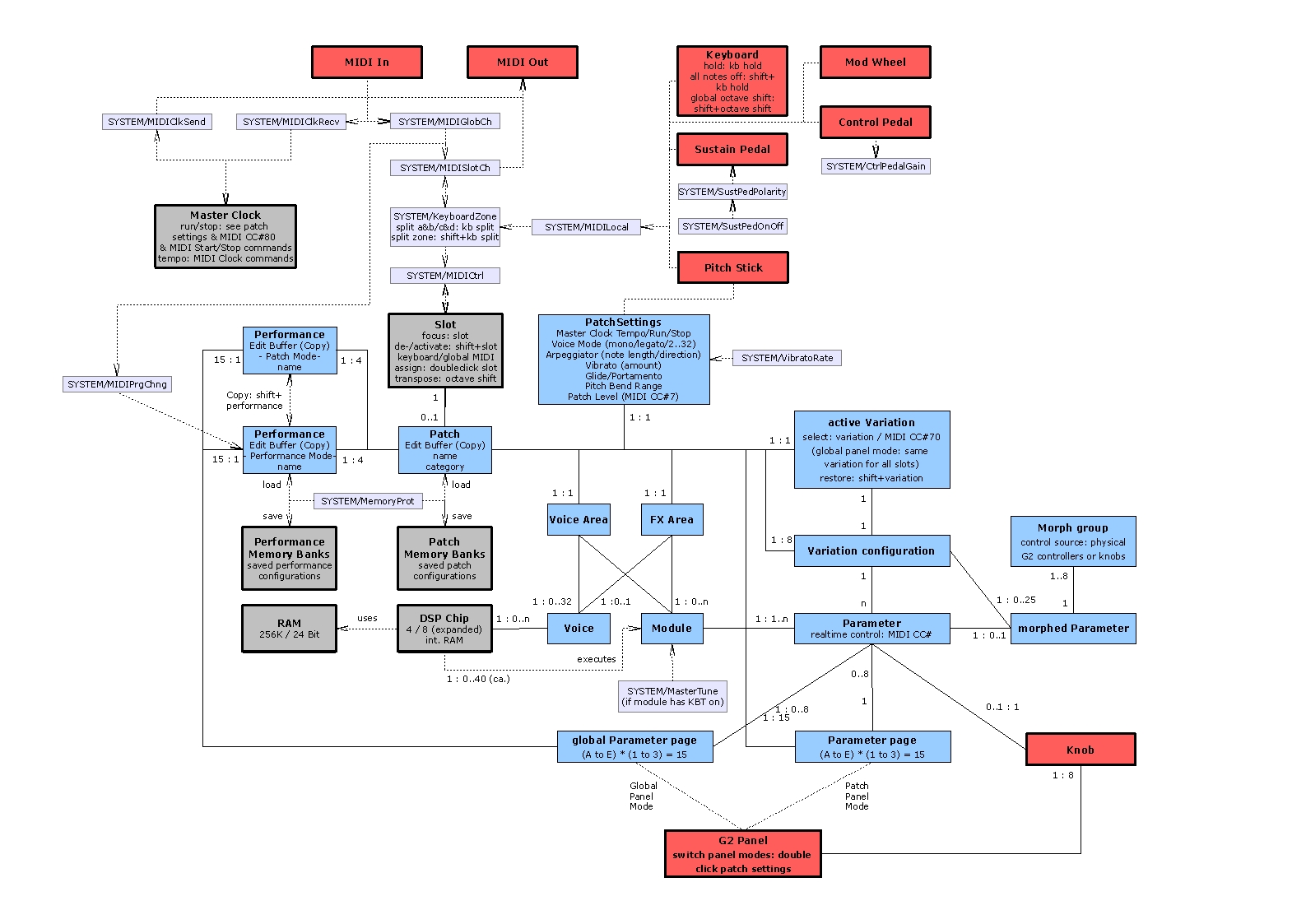

this is a block diagram of the nord modular g2. to me it is easier to have "all" the information in one view. sorry for posting this under building blocks, but maybe this is useful for others, too. to download the image as a file, right click and "save as...".

Moved this to the FAQ, even when it's maybe an answer for which the question still has to be asked, I'm sure it will be asked though Wink
