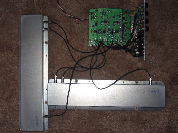

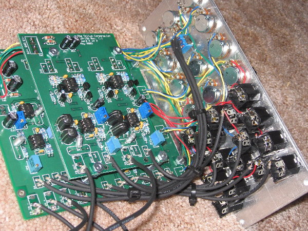

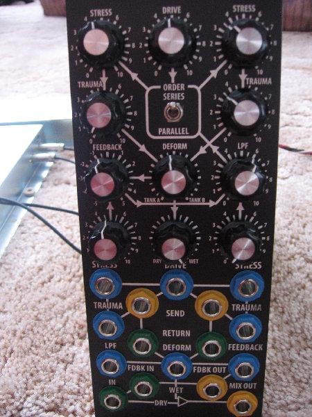

WOOOOOHOOOOOOOOO Very Happy

Show off! mad, short circuit
I mean . . . wow! Wink Great job, you win! well done
I gotta get my act together and get the rest of my parts! Embarassed
Is that your own panel design? I looks really cool! I've got the BrideChamber panel.
And are those Mogami patch cables I spy????! Nice! thumright

niiiice
and that patch is craaazy...

Whoa. Time out.
Way too cool!
Where'd you get those colored jack nuts and washers?
Is that a 2u panel? I've got a bridechamber one here, but haven't built the thing yet - I'd much rather have it in 2u if it can be done (and it looks like it can)

Thanks droogs Smile
It`s my homemade 2U panel. I was gonna get the bridechamber one, but as I watched the evil backlog grow, I realized I would soon have to walk across the room and/or climb a ladder to make a patch if I didn`t abandon the standard MOTM spacing. Just wait til I roll out the 2U doomsday machine. That shit`s gonna be tight Shocked
The nuts/washers are just regular ones with cheap all-purpose spraypaint(has the best selection of colors), then a couple of coats of acrylic (for durability) then satin lacquer(to get rid of the nasty gloss).

What's the point of using shielded cable on the front panel wiring?
Does that cut down on interference as well?

Mine works fine with bananas and without ground.
For the jacks with shielded cable, I just heatshrinked the shielding on that end.
