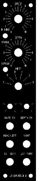

PostPosted: Tue Jan 27, 2009 3:53 pm    Post subject: Panel Design Reply with quote  Mark this post and the followings unread
Here is my preliminary panel design for the DimD. I want it as compact as possible in a MOTM size panel. I've included all the bells and whistles that I could with the 2nd LFO with speed and depth pots as well as their associated CV inputs with attenuation pots just above the jacks.
I don't think I am missing anything or have added anything unnecessary, but if you see something out of place please let me know Very Happy
Thanks,

jhaible
Joined: May 25, 2007
Posts: 2014
PostPosted: Tue Jan 27, 2009 4:41 pm    Post subject: Re: Panel Design Reply with quote  Mark this post and the followings unread
Thanks,
For Dim D emulation, you don't need the Rate and Depth stuff - that's handled in the Presets.
If you want to use the extra LFO (with Rate and Depth), I would add a switch to disable the Preset LFO. It's possible to use both LFOs, but I would at least want to have an option to turn th epreset LFO off.
You've probably noticed: The pins for many of the board-to-board connections on BBD Board and Main Board are located at the same position, so you might be able to stack the boards (with the right connectors) instead of using wires. (Not tested by me - I've only used wires because I have th eboards side by side in my prototype.)
JH.

PostPosted: Tue Jan 27, 2009 7:03 pm    Post subject:
Subject description: updated FPD
Hi JH,
I intentionally left out the switch to turn off the main LFO because there was no room for it Rolling Eyes but after some thought and reading your post I realized that I should include it and to do that I need to go to a bigger panel Confused I think it will be much better this way though Very Happy Cool, thanks again for the help Very Happy Very Happy

Hi JH,
I am starting in on the build of the DimD and have a few questions regarding potentiometer values. I will be using the panel shown below but don't know what value pots to use. Should 100k lin be fine for all? I am using the original DimD circuit as well as the extra LFO on the BBD board.
Thanks,

lexvortex wrote:
Hi JH,
Thanks,
For Depth CV, a smaller value will be better. Like 10k, 22k or 47k.
JH.
