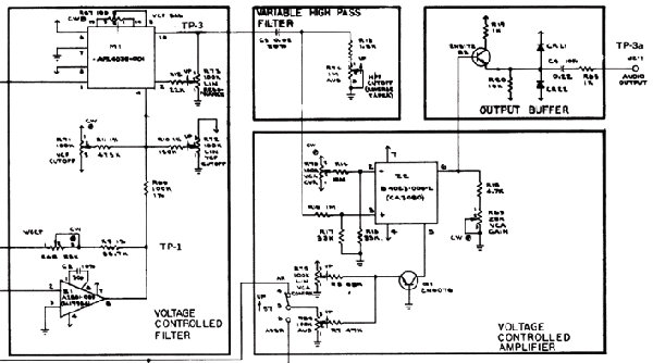

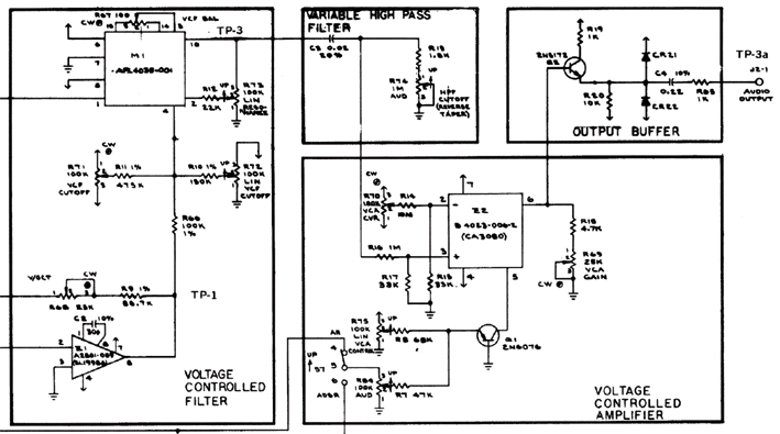

HI PASS FILTER
For sure the point between 10k resistor and J3 connector (6) is connected to ground ?
Nice passive HPF as on Roland System100M filter M-121
funkyfarm
Joined: Jan 21, 2007
Posts: 583
PostPosted: Sun Jan 11, 2009 4:56 am    Post subject: Reply with quote  Mark this post and the followings unread
For sure there is some drop in volume with all these RC network based passive HPF.
This is what active filter are for ? Smile (ie no drop)
ARP put an potentiometer (audio reverse taper) instead of a switch to vary resistor value.
