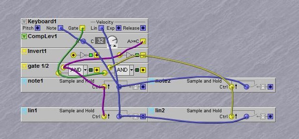

Which module would be convenient to use to split incoming data from another slot so it can be sent to two "synths" in one slot.

Nothing really I think ... the midi note zone module would have to be in another slot ... the range modules that were present for the classic are gone ... so nothing else it seems like using the keyboard module and some logic stuff after that.
 Filesize:  46.03 KB
 Viewed:  394 Time(s)

Thanks, I figured out a similar solution a few days ago. I'm not by the modular right now so I can compare but it's the same basic idea.
