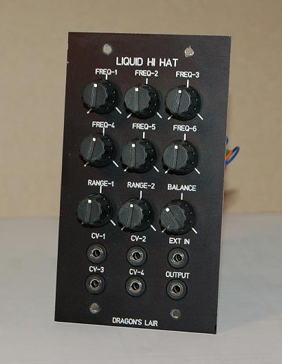

Well here it is guys Very Happy it turned out pretty good, except for the fact that I didn't notice one column was a tad higher than the others (I fixed it on the template)
The Panel is by Front Panel Express, they are a bit pricey but not to bad for Frac sized modules, but when I priced out MOTM sized modules FORGET IT!
I'll have to work on getting some better pictures some day.

PostPosted: Tue Dec 30, 2008 5:03 pm    Post subject: Reply with quote  Mark this post and the followings unread
Looks great to me! Very Happy
Don't worry about the high column. I do my best to make everything spot on, but I like to keep in mind that imperfections will always weasel their way into the final product. That's what makes it DIY! and fun. If there were no stuff ups, it would be made in a factory in China somewhere, and would suffer from chronic build quality issues. I know which I'd prefer. Wink
As for mine, it's half wired, and if I manage to get some time away from all these pesky family and friends wanting to do Christmas type stuff and eat and drink beer and all that, it should be whistling away in a couple of days.

PostPosted: Tue Dec 30, 2008 6:27 pm    Post subject: Reply with quote  Mark this post and the followings unread
Wow! Shocked It's wild to see someone having built a module that I coughed up!! Where's the samples?? Laughing
Who cares about the high column? Like Uncle Krukus said - it's part of DIY! Smile
It looks great though! Come on Unc. Get yours fin. and a pic posted as well! Very Happy

PostPosted: Tue Dec 30, 2008 9:47 pm    Post subject: Reply with quote  Mark this post and the followings unread
Thanks guys, I know that the raised column is not a big deal, IT JUST BUGS ME! Evil or Very Mad

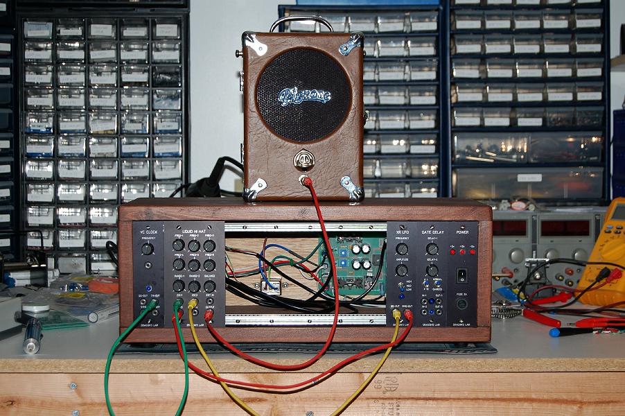

Well I managed to get a sample of my Liquid Hi Hat recorded into my laptop.
This is just the LiquidHH being modulated by my VC-Clock and XR-LFO modules. I had to run the output of the LiquidHH through a preamp pedal, to get the levels up high enough to record.
I don't have video capabilities at the moment, but here's a pic of the setup.
This sample is meant to demonstrate that the module is capable of sounds other than hi hats, Ryk did a fine job demonstrating those in his videos.
