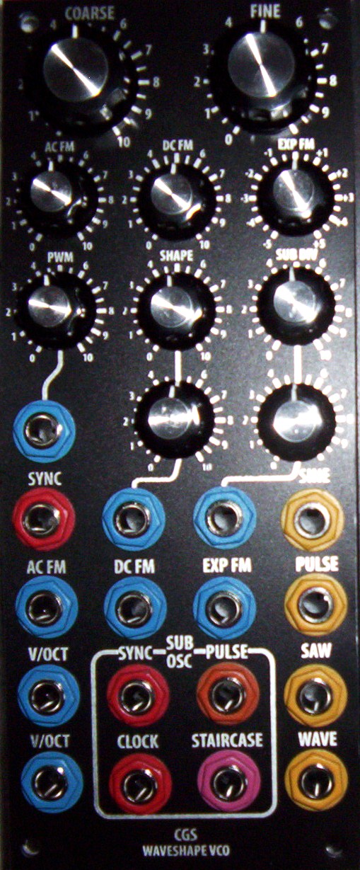

PostPosted: Fri Aug 01, 2008 6:23 am    Post subject: Reply with quote  Mark this post and the followings unread
would love to see pics of anyone's "maxed out" vco front panel... anybody done one in frac/euro format?

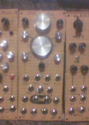

PostPosted: Fri Aug 01, 2008 6:33 am    Post subject: Reply with quote  Mark this post and the followings unread
ive got one in cardboard, it has everything except the sub-osc. i had it with the sub-osc on a 3U panel but decided it could be condensed.
sorry for the bad picture
it is the one in the middle with the two big silver knobs
rolls like this,
big silver knobs - fine and coarse tune
small knobs at top - fm ac & dc with cv atten
small knob to the right of tune is pwm
small knob to the left of the tune is waveshape
small knob under tune is linear cv atten
jacks roll like this
pwm, fm ac, fmdc, Waveshape Cv
sync, linear cv, clk
sine, 1v/0, 1v/0, waveshape
pulse, saw+, saw, stair
our drill press broke otherwise i woud have made the plate for this by know
and ill find some nice ex-ham radio bakelite knobs for it too
those silver ones were just lying around
cgs_vco ala problemchild
cardboard proto plate
rusty version coming soon :)

PostPosted: Fri Aug 01, 2008 8:23 am    Post subject: Reply with quote  Mark this post and the followings unread
Nice!!
Now I know I am probably not thinking straight, but whats the advantage here to have both AC and DC FM inputs?

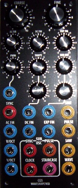

Here's my "maxed out" version. Just missing the above 0-5v outputs I think.

Rykhaard
Joined: Sep 02, 2007
Posts: 1290
PostPosted: Fri Aug 01, 2008 10:40 am    Post subject:   Reply with quote  Mark this post and the followings unread
Coloured nuts and washers for 1/4" jacks???? THAT looks VERY impressive! Very Happy
How much do they cost, per jack??
neandrewthal
Joined: May 11, 2007
Posts: 672
PostPosted: Fri Aug 01, 2008 11:07 am    Post subject: Reply with quote  Mark this post and the followings unread
haha, I wish you could buy them.
But, it was $30 for 6 cans of spray paint.
