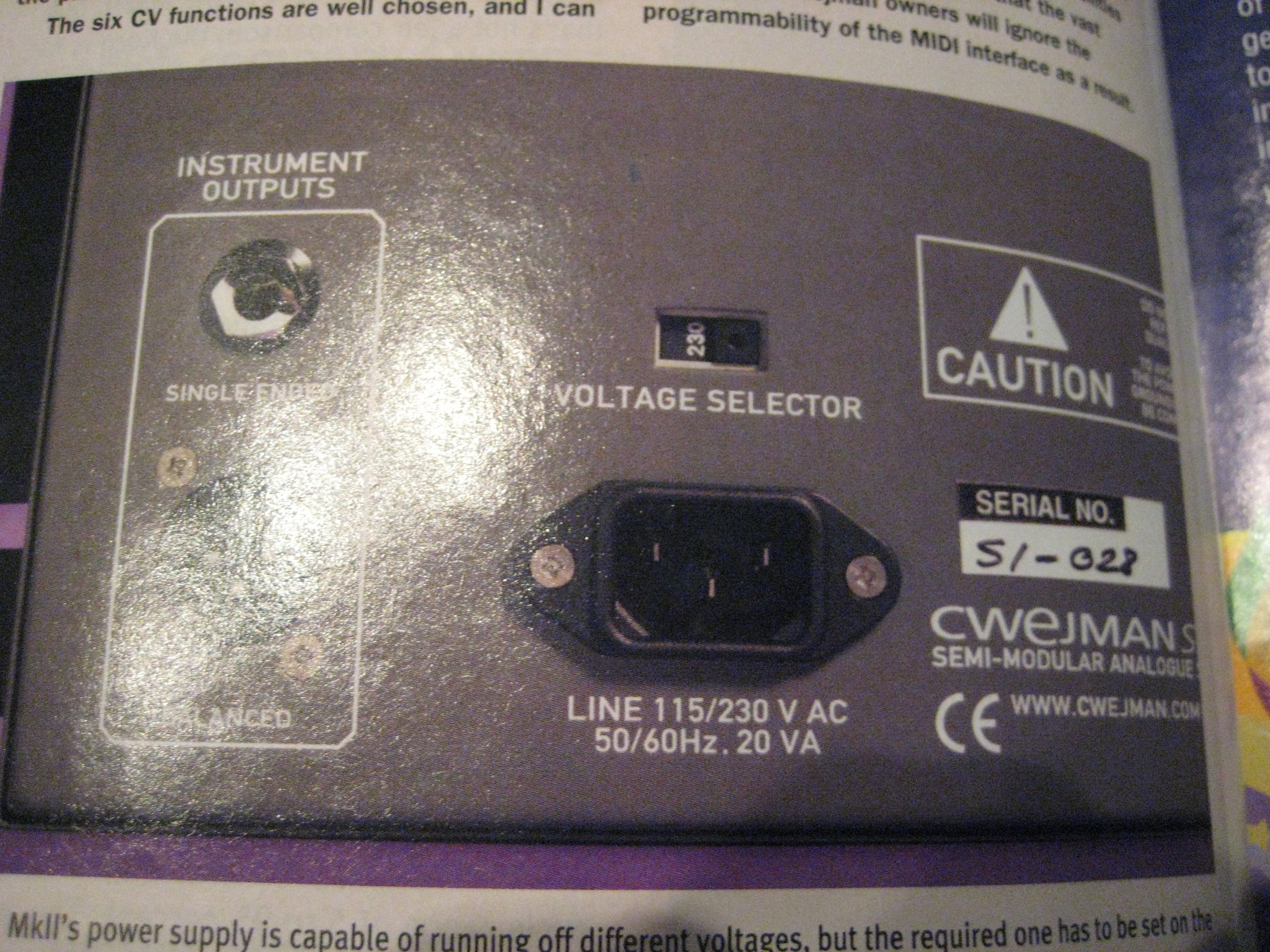

It is the S1MK2. Interestingly enough, the front panel says S1, but the back panel says S1MK2 as well as my manual. Looks like Wowa put the full name on the front panel on the newer units.
Anyone who wants a full in-depth review of the S1MK2 should also check out the soundonsound article (published in August 2004) below.
http://www.soundonsound.com/sos/aug04/articles/cwejman.htm
Sound, is your S1 the MK2 version? What I'm finding odd is if you purchased your S1mk2 from Wowa in April 2006 you should have a later serial than 021. Unless he screwed up the serials. The soundonsound article shows pictures of an S1mk2 for the review and it's serial is 028 (I have the article, it doesn't show up on the web edition). This is back in August 2004. How then can you have 021 purchased in April 2006? Further, my serial appears to be #71, which would seem right given the incremental numbering from the 2004 article above to 2005 when I purchased my unit.
Maybe you can include some pictures of the front/back panels of your S1. If Wowa screwed up the numbering some expanation is in order.
monads

PostPosted: Wed Sep 03, 2008 8:02 am    Post subject: Reply with quote  Mark this post and the followings unread
I didn´t know it! ... My S1 is labeled as a MK2 in the front panel as well in the back panel. Maybe he resets the serial number when he change the front panel?
I did test the "external input" and "white noise output" of my S1mk2 and didn't notice any crossed signals or problems.
These jacksockets are wich are failed in my S1, but it can be in any jacksocket, the majory have the circuits passing under them.
I noticed from eye's view the Cwejman S1mk2 appear a 'hair' longer than the other ones I have. I've never really used the patchcords originally supplied with my S1 so maybe this is why I haven't had any issues?
Yes, if you are using jack plugs shorter than 14,2mm you can not touch the PCB nor debaste the greenpaint, nor short the cooper of the circuits with the tip of the jack plug.
The Cwejman S1mk2 supplied patchcords, at least mines, measures within 14,4 to 14,8mm
It appears the serials were reset when Wowa added MK2 to the end of S1 on the front panel?! It's puzzling to me and makes no sense.

Pic from the soundonsound article showing serial 028 used for the review.
