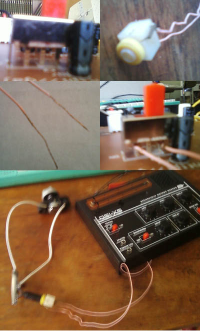

PostPosted: Sun Apr 19, 2009 3:12 am    Post subject: Reply with quote  Mark this post and the followings unread
I just made my first mod to my GAKKEN, a very simple one, no soldering or anything complicated, just a simple wire job Smile
What I did was to put a jack to the resonace switch so I can connect a pot to it that gives me control over the amount Smile Smile Smile
I have to get a better pot though, this one is far too large = 470K Ohms so it only gives me about 5-10 degrees of action but for this test it works.
EDIT: this leads me to a futher qestion, this is probably complicated but what do I need to control the amount of resonance using let's say a LFO?
Or, how is a automated potentiometer constructed, ("VCR"? (voltage controled resistor))
A; the underside of the resonance switch
B; a mono jack
C; end of wires of the jack
D; wires wired to the legs of the switch
E; Ready to rock!
 Filesize:  58.34 KB
 Viewed:  374 Time(s)

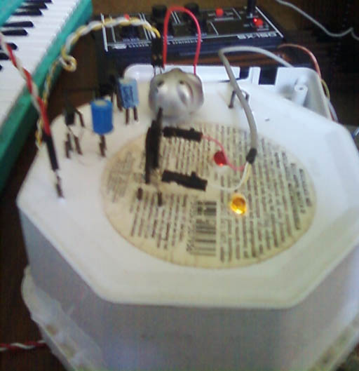

PostPosted: Tue May 12, 2009 9:49 am    Post subject: Reply with quote  Mark this post and the followings unread
It is a astable using two 470u caps (from old telephones), two 546B transistors (old light organ), one 20k slider pot for PW (telephone bell volume) one 10k pot (to small, will change) for speed (bend arm of a broken guitar hero guitar), one red and one yellow LED (computer on and HD LED's). The output I take from both sides of the PW slider and I got a switch (computer turbo on/off) to choose any, the switch also breaks the connection in the middle so I get a retrig when switching, the switch is followed by a 200k pot (old VCR) that controls the end pitch a bit. "All" this is mounted on an upside down ice cream bucket, wires on the inside. To put the components there I have small metal pipes normally used for nylon fishing tackles, but I pinch one or two wires into one end and make a small hole in the buckets plastic and then push the other open end of the pipe so it goes out on the top side, two next to each other for diodes and caps, three for transistors, no soldering, you can switch to a diffrent cap (or whatever) in seconds. Power is a battery box 4*1.5 = 6V (bottom half of a telephone call logger) sitting next to the bucket Razz
(No, I don't have any diode protection resistors (470 or so), it is only 6V so it is not a problem I think)
OK, is this on the lower end of synth DIY or what? Cool Cool Cool
The sound?, Well it alters hi/low pitch, if I take the output from the side where the slider is then I get short high and long low, then I switch and get short low and long high instead, about 1-2 keys difference but it depends on the PW slider, in the middle it is only one pitch. The PW also controls the length of the two halfs (it also changes the speed, in the middle it runs fast, slower near ends and at the most ends of the slider it stops, all is on one side. The speed is also dependent on if I take the output from A or B side depending on the total resistance is changing, wery unstable =)
Well, I took my LED blinker showed in a previous post and used it to feed more power to one half of the circut but in pulses, then I also used the internal LFO + pitch envelop of the GAKKEN, then I used that sound together with chords of my electone and it sounded like Beach boys singing choruses??!! (No, I don't think a reproduction is possible =)
GAKKENIZER 1
 Filesize:  36.23 KB
 Viewed:  19915 Time(s)

Daylight so now I can take better pictures than last night, here is another view of my GAKKENIZER where you can see the constrction better:
 Filesize:  53.82 KB
 Viewed:  19879 Time(s)

You answered your own question. Smile The gakken's got two things going for it:
1. It's not an analog synth. It's a magazine that -- for that issue -- came with an analog synth to help you understand what synthesizers are. That right there has got fantastic geek appeal. Like when they put a digital camera in a box of cereal, a bunch of people are going to go out and buy it and hack the camera. Not because it's the most awesome camera in the world but because... it was in a box of cereal. Same thing here.
2. Once you have a mechanism in place to get reliable pitches out of it, it's actually a pretty cool sounding and useful synth. Not really useful until then, though. Then again, that's why my WSG sits unused on a shelf. Smile
