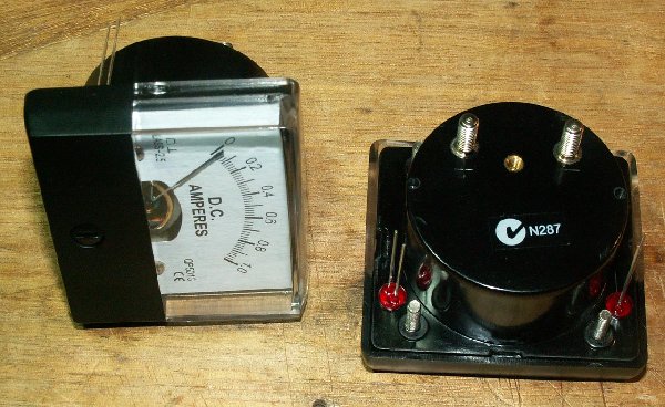

PostPosted: Thu Oct 02, 2008 4:05 pm    Post subject: Reply with quote  Mark this post and the followings unread
I decided to put the indicator LEDs inside the Ammeters, to light them up. Red for the +ve rail, Yellow for the -ve.
If you use the same type of meters, be careful about the placement, so you don't foul the front cover. You'll have to pop the front cover off while you drill. The needle assembly is very fragile, so be extra careful, and get the cover back on ASAP. Wink
The material is a bakelite type of plastic which cracks easily, so drill in stages, ie 1.5,3,4,5mm bits.
I found that 2 LEDs in series work well if you change the current limiting resistors (on the PCB) to 820R. I still haven't tested them in the meters though, so this might change.

PostPosted: Sat Oct 04, 2008 5:07 pm    Post subject: Reply with quote  Mark this post and the followings unread
Just a quick post to let everyone know that I powered it up this morning for the first time, and it seems to be working perfectly straight off the bat! Very Happy
Using 25 turn trimmers, there's about 1/8th of a turn per .01V, so it's dead easy to dial in exactly 15V per rail. I could just as easily dial up 14.99 or 15.01 if I wanted to! Very Happy
The LEDs in the meters are not bright enough for me (though I haven't seen them at night) so I'd probably suggest for two standard 5mm LEDs per side to go back to 680R as on the original schem. I also need to update the stripboard layout, as I added a screw connector for the chassis earth to 0V line.

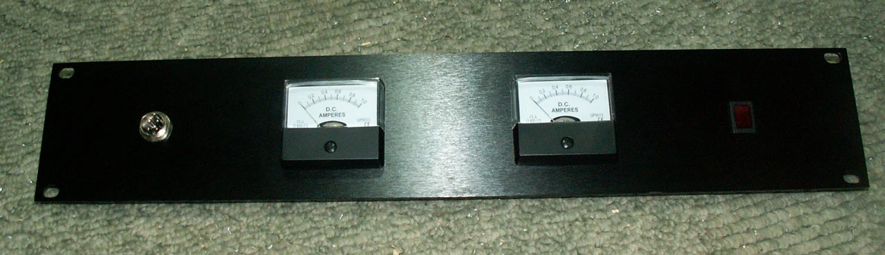

PostPosted: Sat Oct 04, 2008 5:17 pm    Post subject: Reply with quote  Mark this post and the followings unread
Here's a couple of pics of the front panel.
It was actually heaps harder than the back one, as it's about 3mm thick, and my nibbler can't get it's jaws around more than about 2mm. A metal fretsaw, step drill, files etc. come in handy for this stuff.
The 4way mic-type connector on the front is an auxillary out for testing, prototyping, and possibly a handheld softpot ribbon controller. Wink Laughing

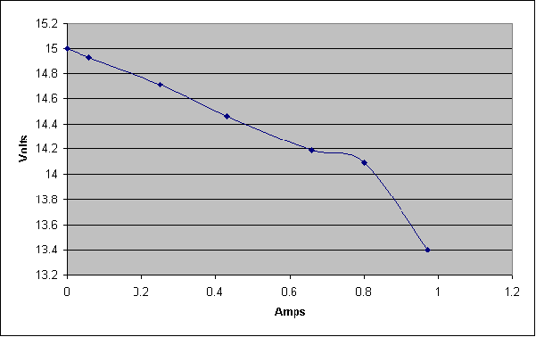

Okay,
Now that I've done some current tests, I must say I'm impressed in some ways, others not.
First, the meters are quite accurate, for what they are. Give or take 30mA, they reflected the DMM reading quite well. I didn't want them to be spot on, I wanted a quick guide as to how much space I had left to play with, and to look cool. They deliver that just fine.
But,.....
I thought the LM723s would keep the voltage spot on regardless of load. As you can see from the attached graph, they don't. Maybe I was being naive about it's ability to track the load and adjust the voltage dynamically. Still .5V drop for the first .4A isn't too bad. I'm sure the LM723 is capable of better though, and I'm going to share these results with Elby and see if I can't improve the design a bit.
On a very positive note, MJE3055s @ 1Amp are still virtually cold!

PostPosted: Sun Oct 05, 2008 2:06 am    Post subject: Reply with quote  Mark this post and the followings unread
I'll put mine on the bench later today and do some measurements
Where did you insert the ammeters ? if you put them after the psu they will introduce a voltage drop, a good place for them would be behind the current sense resistors and pin 3 of the LM and before R106, that way the voltage sense is behind the ammeters and the drop doesn't affect the output

PostPosted: Tue Oct 07, 2008 1:14 am    Post subject: Reply with quote  Mark this post and the followings unread
Sine wrote:
Where did you insert the ammeters ? if you put them after the psu they will introduce a voltage drop, a good place for them would be behind the current sense resistors and pin 3 of the LM and before R106, that way the voltage sense is behind the ammeters and the drop doesn't affect the output.
It would be heaps easier for me to put the meters on the other side of the 1W resistors, (between them and the transistor emitters), but I'm starting to understand why that wouldn't be a good idea. (The drop across the meter and the current limit resistors would skew the Isense and prematurely shut down the current capacity yeah?) So I'm going to put them where you suggested; between the diode and the Isense junction.
BTW Here's a plot with the meter shorted, so I think you hit the nail on the head! Thanks heaps.
