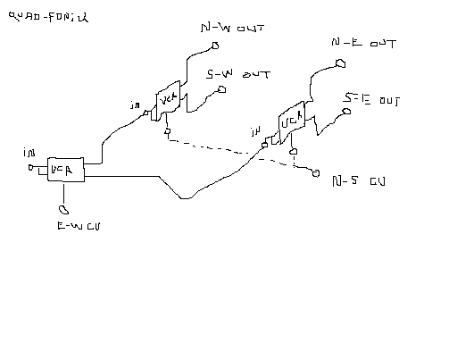

Quad-Fonik setup using 3 of fonik panners pcb's:
If u feed the 2 inputs of the first vcapanner each with a different signal
u have an Quad-X-fonik panner Wink
 Filename:  quadfonik.bmp
 Filesize:  576.05 KB
 Downloaded:  302 Time(s)
PostPosted: Thu Mar 12, 2009 3:46 am    Post subject: Reply with quote  Mark this post and the followings unread
i am curious to see your finished module, teknik!

TekniK
Joined: Aug 10, 2008
Posts: 1059
PostPosted: Fri Mar 13, 2009 4:24 am    Post subject: Reply with quote  Mark this post and the followings unread
am not gonna built this fonik,am gonna give a try to use your boards to do the inverse 4in to 1out ,replacing manual pot by joystick,to obtain vector function like on the prophet vs,its gonna be fun with 4 serge wavemultipliers @ each input..,just need the choice for 8 vco's to complete my VC Taj Mahal Drone Generator
PostPosted: Fri Mar 13, 2009 6:44 am    Post subject: Reply with quote  Mark this post and the followings unread
...if I built a panner resonator with the 2 boards and I ever wanted to use this in mono mode, I would have to pan fully to one side and use that side's output, right? That would provide a more or less equal mix of all 3 input signals to that output?
no. Very Happy
if you pan the LEFT input to the RIGHT, the RIGHT input would be routed to the LEFT output accordingly. that is the "X" in the X-pan/fader. actually this is the fun of this module. LEFT and RIGHT channel move from LEFT to RIGHT and RIGHT to LEFT, working in opposit direction.
if you put the pan to center it would be a mono mix at both outputs, but with a prominent center input signal (maybe we should increase the value of R46/R50 to come around this - 120k maybe?).
however, the PS3100 PCB provides a mixed mono output of the three resonators.
