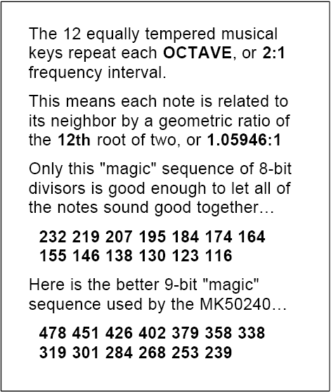

PostPosted: Sat Oct 04, 2008 11:48 pm    Post subject: Reply with quote  Mark this post and the followings unread
I just checked the numbers, and if you bite the bullet and go for 2*8bit counters per note, then your division power goes up to 65536.
So, to make the most of it, take it all up by two octaves and two semitones to the B at 63217Hz.
But,....
I just checked, and we have a 14bit counter in the CD4020! So, if we stick with the "just inside audible" top note of B at 15804Hz, we've got the top octave from just 11 chips! and a shitload of diodes!! Rolling Eyes

PostPosted: Sun Oct 05, 2008 6:58 am    Post subject: Reply with quote  Mark this post and the followings unread
If I had a nickel for every time my brain farted, I'd own this board. Laughing
Anyway, now you're thinking. This is why I still wonder if an FPGA didn't have enough gates to crunch out the hard divisions. If not, I think you could with a fist-full of counters. It would be a board that replaced an IC, but, hell, you can't get the ICs any more, so.....

PostPosted: Sun Oct 05, 2008 3:35 pm    Post subject: Reply with quote  Mark this post and the followings unread
I had such a brain turn around last night, that I set up a dynamic spreadsheet and I was actually very close to finding these numbers!
Now that you've gone and spoilt my fun, I'm gonna make it my mission to find the 10bit set!
But first I think we should settle on a chip! The way I see it, we're gonna have a counter per note, so why not go to 14bit and use the 4020? I'll tell you why not!
8bit to audible means starting around 2Mhz
14bit to audible means starting around 128Mhz!! Shocked
But 10bit to audible could start around 8Mhz Wink
As Jan pointed out, (and I confirmed BTW) 8Mhz is okay if we're up around 15V. But can we control tuning at that frequency? Could we have a pre-count tuning mechanism which simply wasted clock cycles? I'll do some more number crunching.

I was thinking about the 40103. Using a programable down counter such as that would simplify the board heaps as you wouldn't need to do external testing with diodes and/or gates.
I can't see how to up the bit count to 9 or maybe 10 without using external testing, which will mean gates, and diodes, and a lot more complicated layout. Unless we can find a 10bit programmable counter, or make the 40103 act like one?
Maybe it is the perfect place to go for the simplicity of 8bit for this reason, but I was kind of thinking that if we go to the hassle of making a DIY TOG, then we should make it better than the obsolete ones. What do you think?
I'm still working on finding the "magic" 10bit dividers. Maybe they don't exist, and then going up to 10bit would be a waste of time. Confused

PostPosted: Tue Oct 07, 2008 7:46 am    Post subject: Reply with quote  Mark this post and the followings unread
(Where was this thread split from?)
A board of a dozen or more ICs isn't going to be much of an improvement over the original 50240 and it might be worth it to accept the exorbitant price the organ repair co's want for a replacement. That, or persuade someone with the skills to provide a CPLD or FPGA recreation.
btw, 8-bit division is definitely not good enough and 9-bits is only "better."
That's surprising and good news about the 40106 osc stability. All could be tuned simultaneously with techniques discussed in the Lunetta forum.
