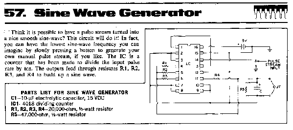

PostPosted: Wed Aug 19, 2009 4:58 am    Post subject: more on cmos and sinewaves Reply with quote  Mark this post and the followings unread
hi again,
just stumbled into this 4018 sinewave generator.
seems worth trying however it mentions a 'pulse' and is not too clear to me what exactly is intended for pulse here..
something from a 555 timer? pulses from 4093? a squarewave?
any ideas?
aero

PostPosted: Wed Aug 19, 2009 8:05 am    Post subject: Re: more on cmos and sinewaves Reply with quote  Mark this post and the followings unread
aerogramma wrote:
hi again,
any ideas?
aero
Wink
this is essentially the same as the link given above to a "johnson counter"... http://www.robthefiddler.com/electronics-audio-diy/circuit-experiments/big-johnson-signal-generator/...
www.fluxmonkey.com

PostPosted: Fri Aug 28, 2009 5:52 pm    Post subject: Reply with quote  Mark this post and the followings unread
This 4018 cct. is pretty cool.
might have to try one with a 4017, or some other counters, got some 4029s yesterday... Binary or Decade sine wave!? Laughing
When I first breadboarded it I just croc clipped one of my existing lunetta oscs. in, one of my Tom Bugs 40106s... I discovered by feeding the clock input with an oscillator that is synced to another osc. produces some very slimy tones! I replaced the 10uf with a 2.2uf, which brought a few harmonics back but the level drop isn't so bad, 10uf makes the signal drop right off.
This is a problem I've hit a few time w/ my lunetta.. need to figure out a decent way to boost and/or build some passive attens in for all the bastard loud squarewaves in other modules!
I also got it running pretty nice with synthmongers simple 2n3904 / 40106 VCO.

PostPosted: Sun Sep 20, 2009 6:42 pm    Post subject: Reply with quote  Mark this post and the followings unread
Don Lancaster describes simple sine wave generators in his CMOS Cookbook. He uses a 4018 walking ring counter and some resistors. The Cookbook contains tables of resistor values for different resolution sine waves.
You could then run through a low pass filter to remove any higher harmonics.
I haven't tried this circuit but it sounds like a great idea.

PostPosted: Thu Sep 24, 2009 3:05 am    Post subject: Reply with quote  Mark this post and the followings unread
I'm surprised nobody said anything about using multiple binary/decade counters with their outputs summed together through an R2R ladder. This would create a high resolution sine (or any waveform really).
I haven't tried it but it should work right? You may need to use quite a few counters in order to eliminate a lot or most aliasing artifacts though. I kind of like that 'digital' sounding wave form.
I was planning on making some sort of module that takes a square wave input and outputs a saw/sine/tri wave using this technique. Each waveform would have it's on "reset" aka sync and other goodies.
