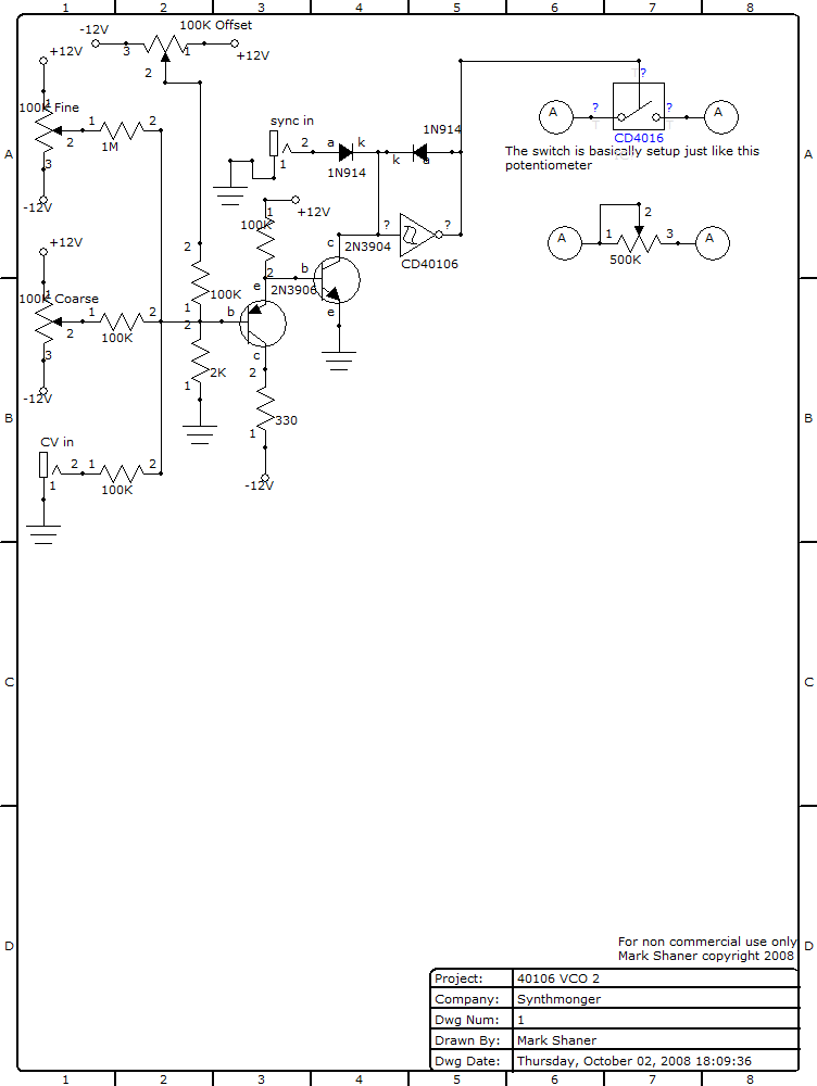

ScottG wrote:
Can you tell us more about the conditions of this setup? I'm unsure as to how synch applies to a filter?? I get synching an oscillator, but not a filter.
Also, can you post your final schematic? (assuming this is the final design)...
Thanks for the demo. Interesting, wierd sounds.
This is taken from the video info:
"In the video I have a single oscillator running through the filter while another oscillator is syncing the vcovr which is controlling the filter frequency. The resonance is set at max and is self-oscillating, which is very unusual since state variable filters are not supposed to self-oscillate. I am just adjusting the frequency knobs and showing the different audio outputs. Not much to it."
I haven't built the CGS switched capacitor filter but I assume it's sync feature effects his filter the same way it effects mine.
I'll try to post the schematic soon. I'm busy trying to finish things for an upcoming show. I might post them as late as mid november.
In the mean time you can check out this vcovr schematic. You should really give it a shot, I'd like to hear your thoughts on it.
 Filesize:  28.36 KB
 Viewed:  1309 Time(s)

PostPosted: Mon Nov 03, 2008 7:42 pm    Post subject: Reply with quote  Mark this post and the followings unread
Interesting. Is the 100k offset a trimmer?
I might try replacing the 4016 in your VC resistor circuit with an LF398 to make a VC sample rate reducer.
Have you tried your vc resistor for a voltage controlled glide?
It would probably work nicely for a switched capacitance filter too (http://www.cgs.synth.net/modules/pic/schem_cgs57_bintic.gif)

PostPosted: Tue Nov 04, 2008 4:34 am    Post subject: Reply with quote  Mark this post and the followings unread
I tried my vco in Bugbrands VC rate reducer and it worked better, plus less parts, sync, expo control etc etc.
Yeah it works well in a VC glide too. As well as EG's and well just about everything.
One thing to note is the linear method adds some distortion that is noticeable in non signal generating schematics. Stick with the 12v/-12v expo for now until I can get the 9V version under expo control.
I use them for my SVF switched capacitor filter.
