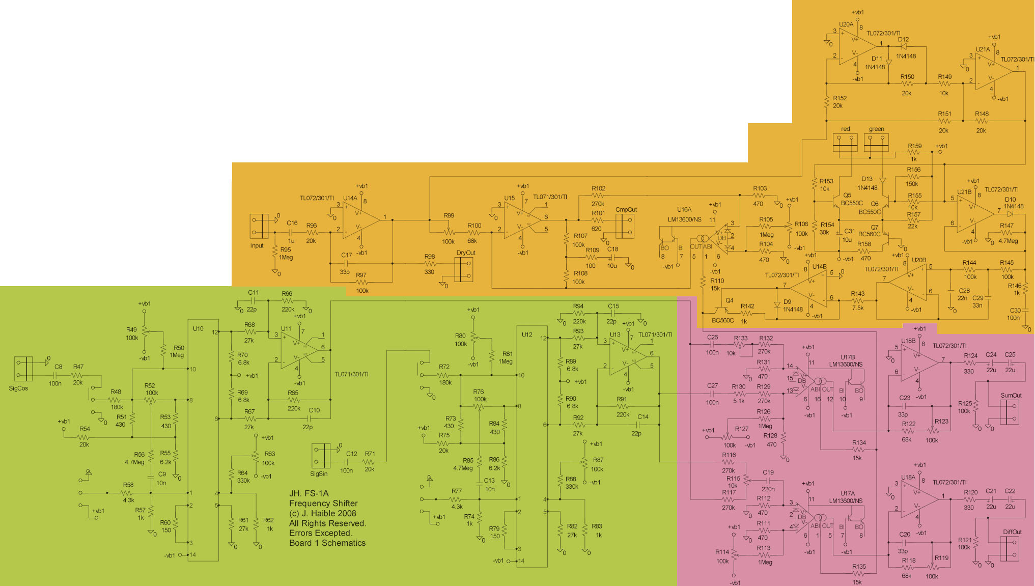

So let's say I build 2 of these boards.
I use one for the carrier and one for the signal. Then I use a balanced modulator, like the MC1496 and sum/multiply them together. And I got a Frequency shifter?
It sounds a little bit to straight forward.. So what's the catch?
Can I use anything else instead of the MC1496? I guess a normal ring modulator wouldn't do?

The catch is that it's a fairly large, involved project. It probably requires lots of adjustment. As I understand it, first one uses a pair of multipliers in parallel on a fixed 20kHZ oscillator and a quadrature VCO. Then we'd process our signal of choice through a Dome filter. The VCO sine and Dome sine are routed through a multiplier, and their cosines are routed through another multiplier. The multipliers outputs are summed and passed through VCAs which use an envelope extracted from the input signal.
You could use MC1496, but a more precision multiplier would probably be far less noisy. It is already a drastic effect, and people say that too little linearity between it's input and output detracts from it's usefulness. If it gets too noisy, the output might not resemble the input any longer! The original called for AD533, but the newer AD633 will probably be fine.
Personally I think it might be fun to try non-standard settings. What if the phases aren't 90 degrees? What if the phases are changing? What if the quadrature VCO can do more complex waveshapes than sine? And yes, it is possible to use a second Dome filter instead of a VCO, but the result would be very complex. I don't know if I'd like the sound, but I want to hear these things.
I recommend Jurgen Haible's page on frequency shifting, where he explains his circuit. I am a noob and only beginning to understand this.
Yes, this is what I'm interested in!
I built Haibles FS1A a few months ago and I like it. But I'd like one that could be very experimental as well.
Here's my idea. Removing the oscillator from the FS1A and keeping the compander (orange), the modulator (green) and the VCAs (pink).
So you feed the input signal to the input and cmp_out to the dome filter. The other you feed straight into the dome filter, then put the signal from the first dome filter into sig_sin and sig_cos. And from the other filter you have the input at R58 and R77..?
(I hope it's OK with mr. Haible that I post mutilated pictures of his schematics! If not I'll remove it straight away!).
