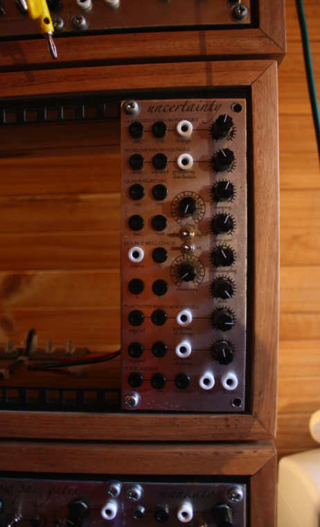

here is my panel btw
i have a Chaquo in there in place of the SOU integrator board as i thought chaos generator and quad osc was a better combo. Still need to add that pcb to the module though Smile
