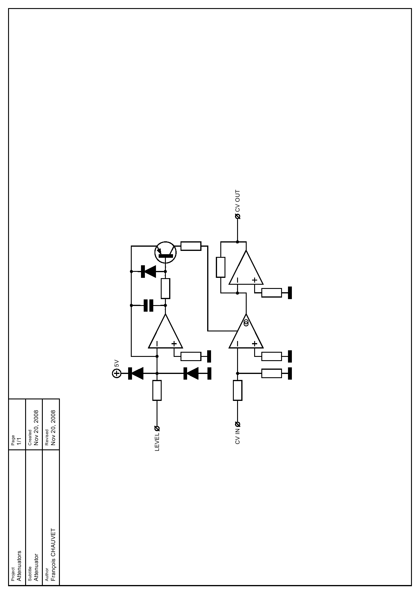

françois
Joined: Dec 23, 2006
Posts: 139
Location: Paris (France)
PostPosted: Sat Jan 24, 2009 11:09 am    Post subject: Reply with quote  Mark this post and the followings unread
Hello,
I use Microsoft Visio, for which I designed a library of component symbols. This is clearly overkill, since Visio is expensive, not included in Microsoft Office (it is compatible of course, but you have to purchase it separately). Since I have it for professional work anyway, I use it.
But Visio is not only a drawing tool, it is more a graphical interface for database applications. As such, it can automatically number all components, edit their properties (e.g. value for a resistor, type for a transistor) and automatically generate a bill of materials. Including the costs if you wish.
Every component has connection points, and when two components are wired together the connecting lines are adjusted automatically (you can adjust them by hand if you want), including the little "jumps" when two lines cross. When a component is moved, the connecting lines are updated.
For the component symbols, I scanned a number of schematics from Elektor because I like their style, and I reproduced them. Attached is an example schemo.
There is a cheap alternative to Visio: Edraw Max. I got it for free from giveawayoftheday.com but it was only a one-day offer. However the full software should cost about 20.00€, which is admittedly more reasonable... and it is fully Visio-compatible!
Yours,
-- françois
