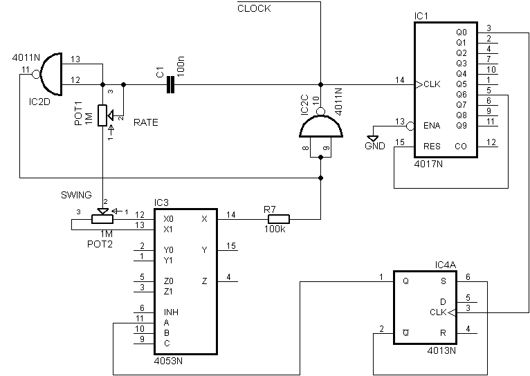

I have a more or less vague idea that you could insert and "eat up" clock pulses at a regular basis to change
the speed in between the beats. But this would be a stepwise change in the swing and involve some three or
four IC's. You could most certainly do something involving an AVR chip or similar. Some sort of master clock unit...
There probably are circuits like this around.

You could create a master clock unit with swing without a microprocessor and the core of it could look something
like this. The 4053 is switched each 6th clock pulse routing the swing pot differently. Sorry, I don't know any
simpler ways to do it... and this doesn't include the reset or run signals.

that's a really great idea. what about if it took the clock and reset/start/stop info from an external din sync source?

You could make that work. I don't have any DIN machines and I don't remember how it works. I think
the other two signals are really easy to realise and we have a leftover 4013 half for S/R action. Two NAND
gates are unused too. I'd need to read up on it but you can take it from here if you like. Hm... you could probably
make some really sick grooves if you put in a switch to make the 4017 reset from other counts than 6...

Something like this... When you set the 4013 RUN goes and stays high and there is a reset pulse for a couple
of ms. You can stop the LFO by tying one of the legs of it's gates to the RUN signal. That way it would behave
in a more consistent manner. You can also take the clock from the other gate if this one don't work.

have to say that I am absoluetely thrilled by the course this discussion has taken. unfortinatly I sold most of my din machines except for the tr 808 and jupiter 8 so I won't be able to loan anything out for experimentation.
but if there are things that I can build and test with my set up let me know and i'll get on it.
perhaps we could develop a really nice shuffle box for all us Din Sync fanatics Smile i'm thinking call it "Swing 24"
-matia

cthulu wrote:
I'm tempted to get on the job at coding something for an AVR processor, it shouldn't be that much work involved.
The problem is I don't have any Roland sync machines to try it on.
No swing for me... Crying or Very sad
I've done a MIDI to Swinging DINSync with an AVR. I got distracted by the sloppy MIDI timing from USB MIDI interfaces,
especially using a MIDISPort 2x2 with Ableton. Anybody know anything
about writing USB device drivers?
As far as I can tell, MOTU are the only ones who have...everybody else uses the standard usbaudio.sys
Where was I...
