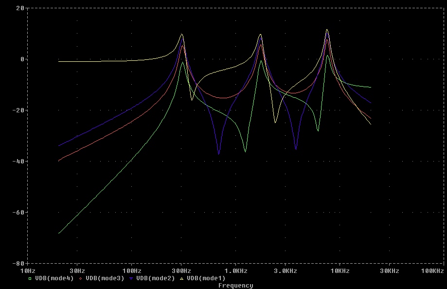

jhaible
Joined: May 25, 2007 Posts: 2014 Location: Germany
Posted: Tue Aug 18, 2009 11:33 am Post subject:
| elhardt wrote: | | /mr wrote: | I agree as well. My point was not really that it would necessarily be better with more bands. At least not if using all bands as resonant peaks - maybe more if some of them are notches, then the module's possibilities could be more similar to a fixed filter bank. But hmm, maybe the Polymoog resonators only go from peak to flat, and not down to a notch? |
The resonator in the Polymoog doesn't have a notch setting. But I noticed on JH's PCB a place where in addition to LP,BP,HP there was something called BN. Maybe that's Band Notch. But if it's like the notch setting on most state variable filters, it would have very little affect.
-Ken Elhardt |
The funny thing is: That mode is on the original Polymoog board as well, but apparently it has never been used.
It is simply this: The "middle" filter section has an extra inverting opamp stage to bring out the BPF. This is to avoid phase cancellation from 3 Band Pass filters in parallel. (You often see this in vocoders, too: mixing every other channel with inverted phase.)
But there is also a mix of the un-inverted BPF, which *does* have the notches.
So on my PCB, as on the original Polymoog PCB, you can choose between 4 (not just 3) settings.
You can clearly see what difference it makes, in my Simulation plot:
http://electro-music.com/forum/phpbb-files/resonator_modes_151.jpg
Orange trace: ordinary BPF mode
Purple trace: BPF mode with notches
And look at those complex transfer functions in LPF and HPF mode (yellow and green)!
JH. _________________ "I tell you the truth, if anyone says to this mountain, 'Go, throw yourself into the sea,' and does not doubt in his heart but believes that what he says will happen, it will be done for him. Therefore I tell you, whatever you ask for in prayer, believe that you have received it, and it will be yours." (Mk 11,23f) |

The resonator in the Polymoog doesn't have a notch setting. |
Purple trace: BPF mode with notches |
Ah, but that's "just" notches between the peaks, not parametric dips. Interesting nevertheless!  |
jhaible
Posted: Tue Aug 18, 2009 4:48 pm Post subject:
| /mr wrote: |
Right! - Never meant to say anything else; sorry for the confusion!
