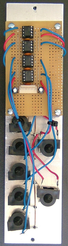

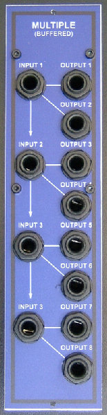

Hi:
After all this time I finally do the circuit in a perfboard. First I tried TL072 but
for pitch CV the error was too big, up to a semitone. I replaced the opamps
with LF412 and they worked perfect, I don't have any noticeable error.
Just letting you know.
Edit: Some pictures...

Hi Sebo,
Sorry to go a bit off-topic, but I've thought of building simple utility circuits like this for myself but there are a few things I'm still foggy on. What value did you use for the bypass caps? Also I notice you only have 1 cap per IC - sorry if this is a thick question but how exactly do you have those wired up - one lead to + rail and the other lead to - rail? This issue is something I'm unclear on - I've seen circuits have 2 per IC - one between + rail and ground and another another between - rail and ground. Do all chips need this or are more stable chips ok without it?
Which also makes me curious about something else I'm not quite clear on - what are the cases where you do and do not need a cap in the feedback path of the op-amp (between the output and inverting input) to correct HFO/stability issues in the signal path? Are some uses of the op-amp more susceptible to this than other uses (the voltage follower maybe not having these kinds of problems)? Or is it that this is a more stable chip?
Also are those 22uf elec caps you used for the power supply filtering?
Thanks.
Sebo
Joined: Apr 27, 2007
Posts: 564
Location: Argentina
PostPosted: Fri Aug 14, 2009 4:25 pm    Post subject: Reply with quote  Mark this post and the followings unread
Hi numbertalk:
The bypass caps are 100nF ceramic, but lately I'm triying to use multilayer
ceramics.
They are wired from +V to -V as the chip is not connected to ground.
The use of bypass caps is a good practice in general, there are various threads
here about it, and some papers around the net that could explain it better than
me, but bypass caps helps to isolate the chip from noise in the power rails,
also act as a little reservoir of energy, so when the chip needs a little more there
are a source handy.
The cap in the feedback path is to avoid high frequency oscillation, and yes
some chips are more suceptible to that than others. I think they are not needed
in buffers because the cap acts as a high pass filter that lower the gain of the high frequencies,
and in a buffer the gain is one (that's why I didn't use them here).
Yes the electrolitics are for power supply filtering, but I'm not sure if I used 22uF
or 10uF (I don't have the module here to check), but anyone will work.
Hope this help.

PostPosted: Fri Aug 14, 2009 10:55 pm    Post subject: Reply with quote  Mark this post and the followings unread
Yeah, I remember someone (I think it was Ray Wilson) saying that the feedback caps are mainly needed once the op-amp is providing a gain of *10 or more. This will vary, I s'pose a gain of *9 might need a little settling. Anything from 10pF to 100pF IIRC. You won't hear any difference until they get bigger than 100pF, but I s'pose anything will take the edge off a transient. Which may or may not be okay.
daverj
Joined: Jul 07, 2009
Posts: 28
Location: USA
PostPosted: Sat Aug 15, 2009 10:53 am    Post subject: Reply with quote  Mark this post and the followings unread
It's better to use two bypass caps, one between each rail and ground, rather than a single cap between rails.
A single cap between rails will reduce noise between the rails, hopefully preventing the chip from oscillating. But it does nothing to reduce the coupling of that noise to the signal.
Even though the chip doesn't have a direct connection to ground, the signal you are feeding through it is a voltage relative to ground. Any noise in the power pins relative to ground can get coupled into the signal.
Modern op amps have fairly good isolation between the signal and power pins, but it's not perfect. And the higher the frequency of the noise on the power pins (relative to ground) the more of it will get through into the signal.
