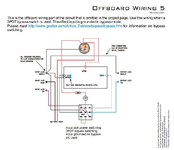

tonepad.com has some really useful articles, schematics, board layouts and wiring instructions. Here are some options for installing the bypass switch on your sub commander:
http://www.tonepad.com/getFile.asp?id=76
I recommend breezing through their site and checking out some of their other plans. It has helped me out tons on my guitar effects projects.

PostPosted: Sat May 02, 2009 4:12 pm    Post subject: Reply with quote  Mark this post and the followings unread
Thank you!
It appears as if #5 is what I would want to use, right? And just modify it for bipolar power?

PostPosted: Sat May 02, 2009 7:50 pm    Post subject: Reply with quote  Mark this post and the followings unread
Yeah, you'll want to use both positive lugs on the power jack like this diagram illustrates...

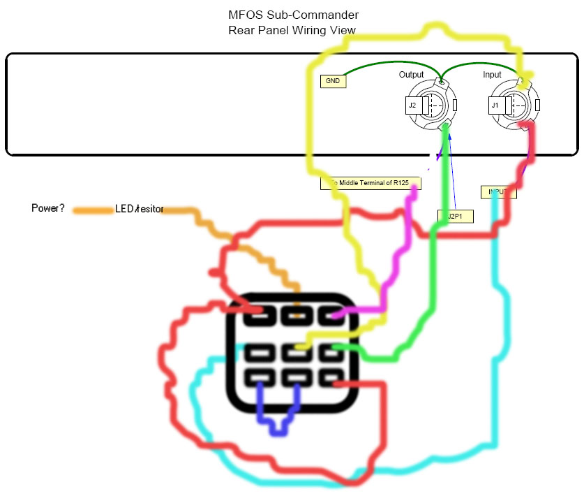

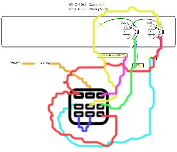

PostPosted: Sun May 03, 2009 9:13 pm    Post subject: Reply with quote  Mark this post and the followings unread
Here is a quick and maybe accurate illustration of a bypass switch for the sub commander.

Wizard Mike
Joined: Jan 26, 2009
Posts: 52
Location: Charlotte
PostPosted: Mon May 04, 2009 8:36 am    Post subject: Reply with quote  Mark this post and the followings unread
Or you could make this...
