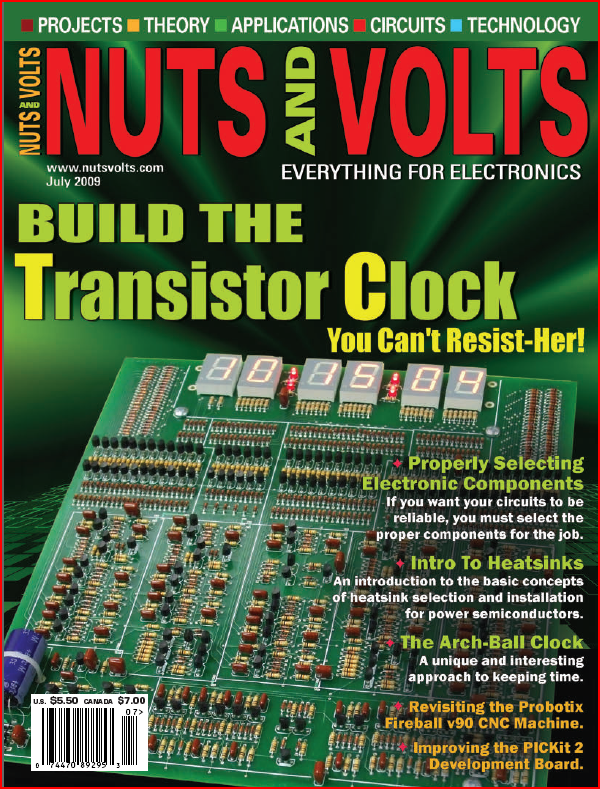

I have always had a fascination for time pieces. Especially for electronic ones designed using digital logic. I had worked part time as an engineer and designed in a "smart clock" digital timer and clock module for a garage door opener system using a microcontroller and a few hundred lines of assembly code and even though I use these modern methods, I still am fascinated with design methods of yesteryear. Continuing my fascination with digital time pieces early on in my career, many years ago I designed a digital clock using bunch of MSI TTL logic IC's which were all crammed onto a 4" x 6" vector prototype board. I am a sucker for anything nostalgic and the latest offering by "Nuts and Volts" magazine really sucked me into this one and I ended up purchasing the kit today that they offer on their store
The feature article in the new July 2009 magazine describes a 12 hour format digital clock that is designed using what is considered a very old and outdated logic by today's standards ...... diode/transistor logic.
Why bother doing anything like this you ask? Well doing a clock design with nearly 200 transistors and over 550 diodes is no small feat, and, it really gets you thinking of just how a toggle type or "T" flip flop (TFF) "really" works using crossed coupled BJT transistors and current steering diodes to facilitate the toggle action. Or how to design a transistor based comparator with hysteresis or wave shapers. It gets you thinking "inside the box" and gets you past that "black box" mentality. Of course, you would be laughed out of your design department using this methodology and normally you would be using integrated circuits or programmable logic for your designs BUT for hobby purposes and understanding logic circuits at the transistor level, you can't beat these sorts of projects.
Some early computers that used this very logic design technology were the Philco 212 shown below and the IBM System 360 series. Also, don;t forget the TX-2 computer, and the sketchpad drawing programs, that was built using discrete transistor/diode logic circuits, at Lincoln Labs. It really was a precursor to modern CAD drawing systems.
What next? Well, going even further back, how about a digital clock made with vacuum tubes? I am not willing to go that far but it really makes you appreciate ENIAC or Joniac series of mainframe computers with 1000's of tubes!!! The ENIAC computer, used flip-flops composed of vacuum tubes enabled the first computer to represent numbers electronically.

Here is the technical manual for the transistor clock in case anyone wants a closer look at this project.
Here is the website for KABtronics in case you want a look at their other items.
http://www.kabtronics.com/index.htm
It's also worth noting that a NIXIE tube version of this clock will be released sometime in the future by KABtronics. It probably would not be much of a stretch to modify the current kit by adding an outboard power supply and NIXIE display and just tapping off the 4-to-10 decoder outputs to drive the NIXIE displays. This way you could have both 7-SEGMENT LED displays AND Nixie displays showing off the two technologies.
